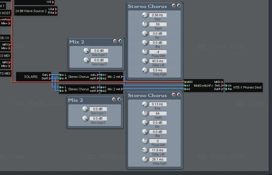

Re: Modules Pack SAL
I have to finish my newest way to use Solaris live this weekend,
and MIDI FX Switch has really been helpful, but I couldn't find a
really clean chorus.
I love the color of such FX but on synths, detuning is usually my
preferred choice.
However I noticed how the signal is not phasy/colored, and reminded
me of my Ensoniq DP4 I use to use Post analog mixer live years ago
so I decided to try something, and now I am quite satisfied.
I was ready to sell Solaris and the XITE-1 after learning they were half
full jars.
Thanks for filling my jar more and saving me from that back of the cone
sound that plagues Native synths on larger midfield monitors and full
systems controlld by FOHs...
I do have a question though.
Is the clarity I am hearing because of the SDRAM?
I just finsihed using several other Chorus Devices and the 4 clearest choices
are your Module and RoyTs Flanger/Pitch Shift modules.
These IMHO are too clean to use on samples, i.e. A Fender Rhodes sound
through Flu-Liq, Modular Choruses, and other Scope FX, Nuetron ADT, etc. are my
choices as the coloring is georgeous and well suited.
I am very pleased as I have flip/flopped w/ chorus FX for years, to the point of using
no Modulation, but the PShifters and your Chorus are perfect for synthesizers.
Is this possible due to the SDRAM...?
Thanks Again
