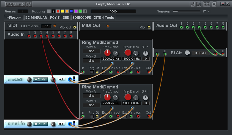

jhulk wrote:create your own with an lfo and panning control
2 constant frequency controls with 3 way switch 0ff /slow frequency/fast frequency to lfo frequency input
lfo to panning circuit and a dual tube modules for the tube fx
if you time the frequencies right you can get a good leslie simulation
i have added this fx for the kawai k3 emulation as its additive engine can create all b3 drawbar additive sounds but only had a chorus fx
but when you put a k3 through a leslie speaker you can get some great organ patches going
and if you set each osc to 2 different waveforms and modulate the crossfade function you can get organ morphing sounds from organ drawbar wave to harsh digital wave

in modular it should be easy with out sdk just using modules available
roland has sdk6 maybe he could create a leslie modular simulation module

I am using RingMod, Diodes and other waveshaping modules trying to get the perfect sound of the Leslie Tube Pre Amp as we speak.
We have a decent Rotary already in Scope, it's the Digital Distortion thats tough to get an equal effect up and down the keyboard with.
I am still using this for my B2003 until something better comes along.
Re: NSA on the internet is looking better and more trustwort
Here's just a hit and miss try using these 2 modules and 2 x inputs of the B2003s signal.
Odd that the sound gets thrown around like a rotary effect, but the clipping is uncontrollable for a newbie like me.

jimmy if you are getting clipping try using level controls for the b2003 before hitting the ringmods as the signal might be to hot from the b2003 outputs
and see if you can reduce remove clipping
dante its nice that you can control rotary fx by mod wheel but the original equipment never had it so to achieve the correct type sound you have to emulate
the original frequency of the rotor 2 speeds fast and slow

also jimmy because the rotary fx makes the mono b3 into a stereo signal try and just have 1 audio input
from b2003 and have that go to a panning module and have its mod input with a switch with 2 lfo with different speeds
then have it goto the ringmods
when i get back ill have a play with it and see what i can come up with
