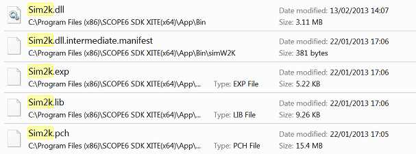

no they are NOT the same even with the same name in scope xite 5_1 and sdk6
i think sim.dll is a catch (exception e) relict from win98
good vibes

Hmm, I checked and I certainly don't have a sim.dll now anyway. Here's what I get when searching for sim2k, which looks similar, although not identical, to what you have.
Either way, it's working ok for me now but wasn't at some point and isn't working for others. Mysterious!
