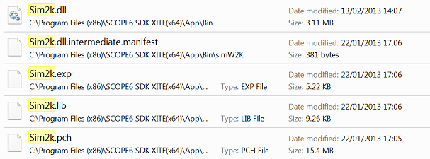

Hmm, I checked and I certainly don't have a sim.dll now anyway. Here's what I get when searching for sim2k, which looks similar, although not identical, to what you have.
Either way, it's working ok for me now but wasn't at some point and isn't working for others. Mysterious!

w_ellis
Posts: 572
Location: Berlin, Germany
Re: SDK 6 installation
Post by w_ellis »
I have a new lead in the sim.dll mystery. I accidently tried to launch the SDK6 while Scope 5.1 was running in the background and the sim.dll error popped up (I'm now running 32bit, so hadn't seen it on the new install before). Closed 5.1 down and reopening SDK6 back up again and all is well again.
Hope this helps other people get up and running.
