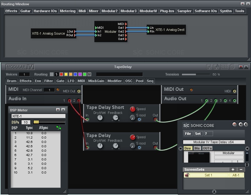

It should work with that ver of Modular IV on XITE under 32 bits. I got the delays working for this article on XITE-1D
http://www.hitfoundry.com/issue_06/tapeecho.htm
I do remember I had to rebuild the Modular patch from scratch after applying the patch, as it seemed the crash from the original tape delay corrupted the modular patch. I dont think I had to rebuild the entire project, but you could build a small one from scratch to try eliminate that possibility if you havent already.

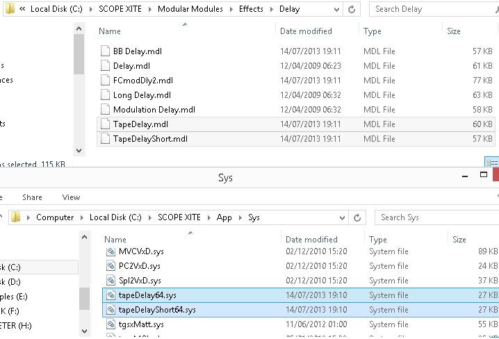

I am using 32bit Scope 5.1 as well. I never tried tape delay in Modular IV until today. When I tried it I experienced the same problem you have been having. I easily resolved the problem by downloading dawnman's files and installing them. Place the files tapeDelay.sys and tapeDelayShort.sys in the following path:
Scope PCI or XITE/App/Sys

I can confirm Modular IV Tape Delay(s) working here on Win8 x64 Scope 5.1 XITE-1D once garyb's FTP download patch above has been applied - from there I got the tape delay sys and mdl files.
Re: Mod IV Delay files missing

I have encountered the same problem and to solve it, i needed the 4 files included inside the zip file.
You have to copy all files into your app\sys folder and replace the existing ones.
It worked for me, hope it will for you too.
