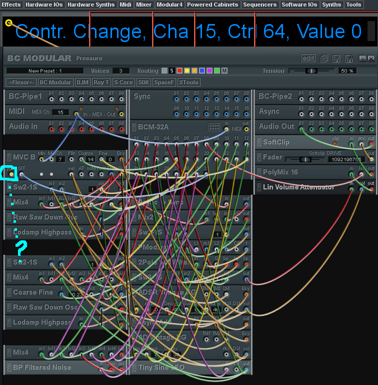

I do have a question though about the MVC B.
I love the way the connector jacks always color themselves when occupied, but I wish to know what might be connected to the yellow covered jack, as I see no cable.
And secondly what is GIT..?
Thanks in advance.

You're right ! I didn't see it either. :D

dawman wrote:I do have a question though about the MVC B.
MVC B has a GUI bug. The connection indicators don't show correctly. I'll fix it for the next update.
The yellow covered jack you mention Jimmy is for Portamento/Glissando Mode control. The one next to it labelled GlT is for Portamento/Glissando Time. You can see these long names for all connectors in BC via the tooltip when you move the mouse pointer over them.

You're the best Sharc.... :D
