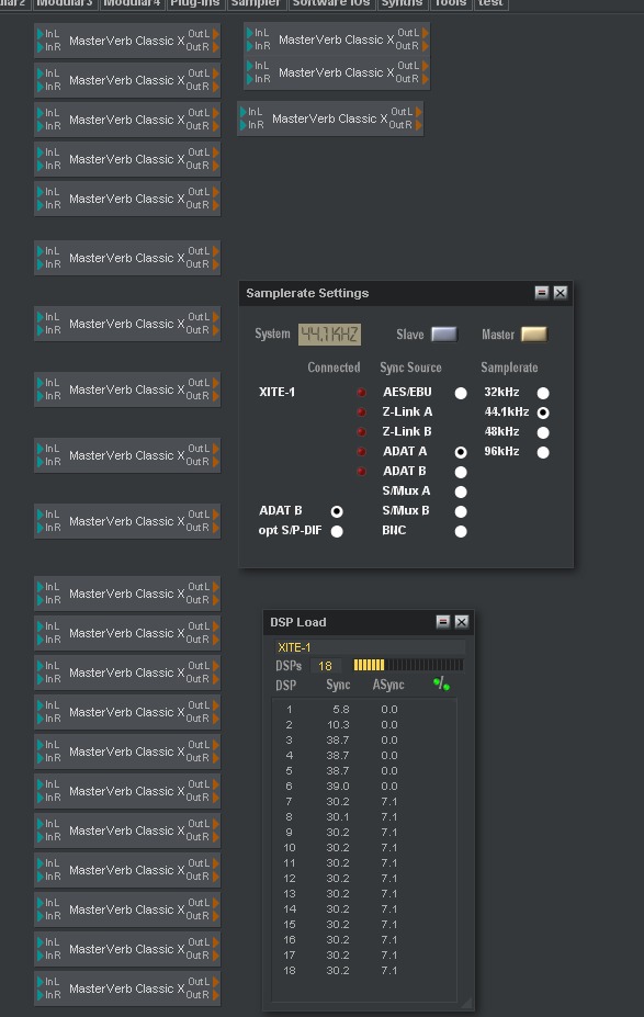

I also used this trick with renumbering the boards to make my 14DSP-board to be the master.
Nevertheless, the performance of Xite1 is a big step forward compared to pci.
As I'm still on pci, but I also own a Xite1, I just did the famous Masterverb-test on the same PC-Hardware ( Asus P7P55D ).
Result: Xite1 can handle 23 Masterverbs.
As my setup didn't reach the limits of pci yet, my migration towards Xite1 is a process of years
				- Clipboard01.jpg (98.99 KiB) Viewed 9338 times

Masterverb test doesn´t count for XITE-1

So, you say it still makes sense performing the masterverb test on XITE ?
IIRC, I got the same result dawman posted some time ago,- 60 masterverb /XITE-1,- even on my old WinXP machine,- ASUS P5WD2 Premium, Intel 955X chipset, PCIe 1.5, D945 dual core proc, Mushkin DDR2.
Then I wondered why I got so bad results w/ big ZARG synths and in opposite to other´s here.
Now I wonder why Nebelfuerst´s limit is 23.
Must be many (unknown) factors affecting performance.

Re: DSP Overload message
it's not significant.
both are beyond the practical limit. there are many factors including how the test is done(retry or not?), how well the motherboard works(performance is not always equal), and possibly the graphics card. generally, i believe cards are better, but onboard graphics are ok, too. in any case, PCIe generally does not have the issue. the whole drama of PCI overflow is certainly based around PCI cards. everyone is always trying to exceed limits, but the gain of doing so are often minimal. as you know, it's more about having a useful tool, than simply specifications.
believe me, stubbornness is a bigger issue. before all-in-one boxes, we spent our time on music and audio. there was no other choice. i've seen the music business(especially the music making business) go from a sound thing, to computers. i think priorities are bit bit twisted, i mean obviously computers are super useful, but for what purpose? well, the rant is probably out of place, but in the quote above, i was referring mainly to IRQ problems. IRQ problems may or may not be involved in PCI overflow messages, but only in the sense that when the Scope hardware cannot communicate with the processor in a timely fashion, data is lost(clicks and pops). if the timing is REALLY messed up, then the logjam can be interpreted as "not enough bandwidth" or PCI overflow, even if technically there may be bandwidth available. it's a real-time thing. audio is time dependent.
soooo-the difference in reports in not statically meaningful because it's only a few reports, but neither system would be prone to PCI overflow messages with an XITE. i have stacked a lot of masterverbs with XITEs, it gets boring putting all those things in the routing window. an XITE-1D can max out the dsps with masterverbs before overflow. a masteverb test is only meaningful with an XITE if the nuber is very small, which would mean a hardware or setup problem.

 things that stretch sat connections to their limits might be best locked to a middle dsp, or something...
