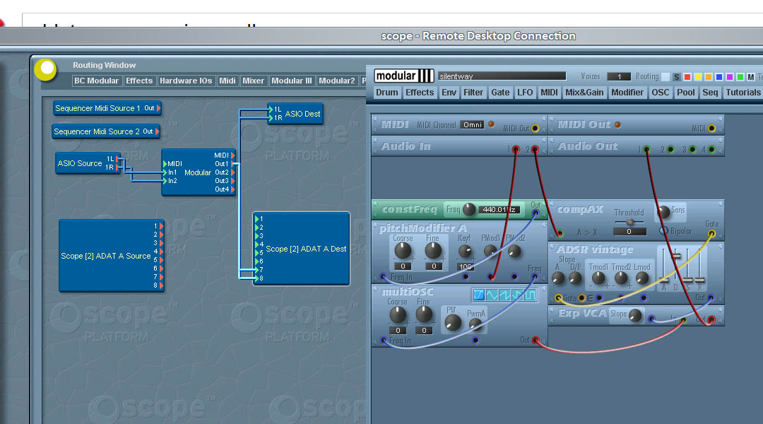

Posted: Wed Jan 12, 2011 9:11 am
by Neutron
back to the question of getting scope modular to get full range, here it is :)
it can be calibrated right from silentway voice controller as well.
Here is a simple example of
how i got full range on scope modular with silentway.
you can use the gate to multiple envelopes without esync,
and i looked at the silent way calibration text, and it has negative values, that is a good thing because it can use the full range of the output and the hardware offset/amplifier is easier to make.
Re: Successful Full Range with Silentway Voicecontrol
Posted: Wed Jan 12, 2011 4:23 pm
by tomylee
looks nice, though you dont need those modules, simply connect output 1 of silentway to the freq input with the calibration txt file I supplied ;)
for the gate I used an inverter I guess, gotta have to look it up, just found out a mayor issue with sfp5, i cant load older projects, he asks me for the registration of several plugins like sts5000, channel, stm 2448, and when I supply them he just wont load those plugins, I load an almost empy project, but thats another thing...
