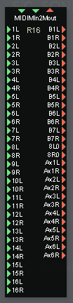

If we imagine that there are no other problems with the "dsp assigment" is my dream now would be a modular mixer 2.0.
8 stereo bus
6 stereo aux (or 1 bus + 13 aux)
new 16 and 24 routers.
8 stereo bus
- DreamMasterBus.png (211.28 KiB) Viewed 5226 times

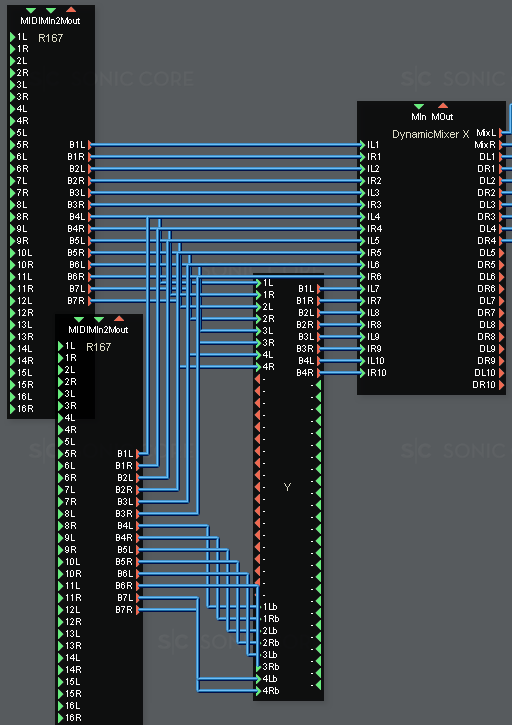

I can do everything from the fact that there are, lacking only a router.
May be 32 x 14 router? universally, not need merger...
- auxbusrouter.png (79.85 KiB) Viewed 5202 times
- Rout16.png (7.03 KiB) Viewed 5202 times

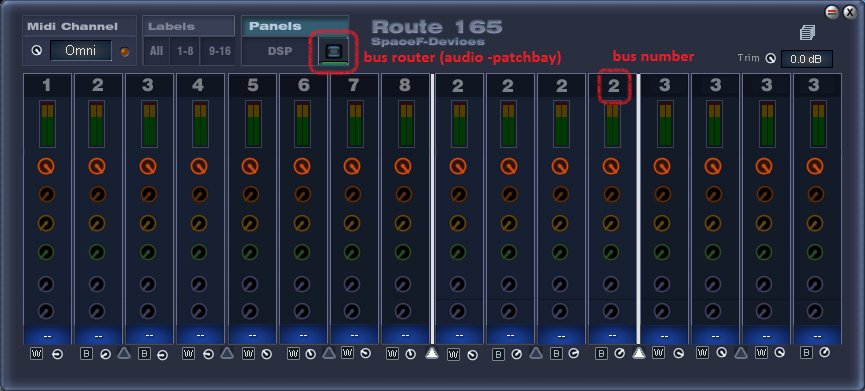

Re: Modular Mixing
6 BUS 4 AUX.
client will be pleased.
Edited: router 16x10 definitely will not be hard for XITE.
- 6bus4Aux.png (36 KiB) Viewed 5078 times

Using this technique, I've built a 32-channel stereo mixer, with VCAs (for Compress/Gate/Expansion with Modulation) on EACH channel, 7 stereo AUX sends, 7 stereo buses, 1 Mix7, and 1 MB7 (this is a sub-mixer for my Aux effects, so effects can be chained here). ALL IN 2 DSPs. For those with Modular Mixer, that's:
(2) Side Chain 16
(2) Router 167
(2) Stem 167
(2) Merger Y16-16
(1) Mix7
(1) MB7
I'll play with this more, and probably add a channel in front of the SideChainers for EQ, Compression, etc. Until I played by the rules I listed, I was hitting SAT errors constantly. Once that happened, SCOPE would crash often (the application, not just DSP overloads). Last night I did a 5 hour jam, and had absolute stability. It seems that saturating DSP communications has a direct effect on XITE-1 stability. So get this part right, and the rest will be better.
Oh, if you start seeing "SAT Error, no more communication available between DSP 9 and DSP e", where the second DSP is listed as a letter instead of number...you know a crash is coming soon. SAVE YOUR PROJECT NOW.
I think similar rules apply to the MasterVerb, or any device that requires communication with the Host for processing: Place them in DSP 10 if possible...this is lowest latency, and also shares the high-count of SAT connections to DSP#2, where the communication to the Host PC happens. This will place a lesser burden on the resources of the system, so you can do more elsewhere in the project.
