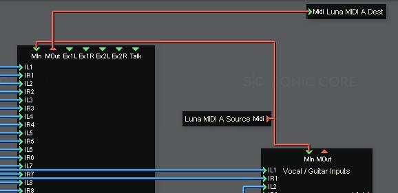

Champion, heres a screenshot of one of my BCR <==> STM projects. From this I get bi-directional control. STM mixer is on the left. The top row of BCR knobs control a input reconding/foldback mini-mixer.
1) Use MIDI I/O instead of USB - from memory you cant get USB MIDI into a Scope project ( without routing it through some intermediatry like MIDIOX, hubis etc which Scope can see ). Correct me if I'm wrong on this anyone....
2) It doesn't really matter about being aware of individual controller numbers. From memory I activated some standard layout on the BCR years ago and havn't changed it since ( which is why I cant remember which one it is..).
Because then all you do (once you've got the connections up) is right click each STM fader ( or control ) and theres a 'learn' box comes up. You click some icon or other and then you twist the BCR knob, the controller number will pop up in the box and its mapped to STM ! Repeat 24 times for each fader..... then map yer top row of knobs to whatever else you want...
Sounds similar to what you're doing except I dont bother maintaining 'presets' on the BCR or the STM. Once I have a working STM project I use it as a base for the next project.
Also, the way I've connected STM to MIDI is totally independant of Cubase. So it doesnt matter whether Im using Cubase or Reason / Record standalone or no sequencer at all..it just works.

Dante,
Thanks a lot for your input, this will help me for sure! :)
The only challenge for me is that I have two project cards (and one booster card without I/O), and both their midi connectors (in AND out) are occupied, because there are more hardware synths that I've connected.
Tonight I'll check If I can free up a pair of MIDI in and out connectors to hook up the BCR.
Will report back...

dante wrote: You could get one MIDI merge box and one MIDI splitter box....I always have a coupla those spare they come in handy.
Thanks, yes I figured I need one of those mergers and thru boxes (4 channel) for more midi controllers in the future. But that will cost me an additional 150 euros..
I'll put this on hold for a litte while longer, and keep this all in mind.
I don't see any sequencer source and destiny modules in your project screenshot a couple of post above. For automating and recording fader movements I assume that the sequencer source module has to go to a midi merger in the scope routing window as well, to merge midi source (BCR/BCF directly controlling STM mixer) and seq source (automate the mixer from seq) into the STM mixer, and the same goes for the midi out from the STM to a midi splitter in the routing window and splits the outgoing midi data to both the sequencer dest (recording fader movements, etc)and midi dest (visual feedback on the LED rings).
Is my way of thinking correct?

Posts: 5089
Re: Tactile control Apreciation/Opinions please.
Astroman : I agree regards the iPad touchscreen, responsiveness and competitive compared to others. The controller market is sort of half and half regards DAW software vendors making thier own ( like Steinberg ). Many others just rely on generic MIDI controllers - with templates supplied either by the DAW software maker or not. Remains to be seen whether iPad would change this ratio...Sonnicore's focus is DSP - hope it stays that way cuz they're so damn freakin good at it. I tried Optimaster for the first time last night and it blew me away.....
Imagine the vibe on this forum if we ever heard Scope 5.x was delayed cuz developers tied up playing with iPad API's......
ChampionSound : I dont automate my mixes - in fact I dont use the BCR too much - mainly because I dont have a template printed up for it showing what each knob controls - due to the laziness of the knob that bought it :). I just use non-destructive level editing on a track by track basis. So an automation scenario probably would involve Seq source & dest. If I was to do that I'd probably ( as you suggest ) experiment with SCOPE MIDI merge / splitter in Scope project, so that the BCR could control the mix directly (as well as the sequencer track when I wanted it to) without having to select the automation track in sequencer.
So yes, MIDI merge/splitters outside and/or inside the box would probably give you the max possibilities....
Heres a merger for $79US http://www.midisolutions.com/prodmrg.htm
And a thru for $49US http://www.midisolutions.com/prodthr.htm
So thats only $100 Euro to do what you want....and Im sure you could get 'em cheaper if you hunt round music shops and break thier balls a bit...
