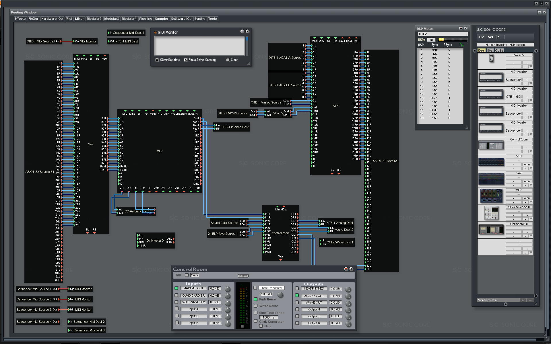

I'm still having problems loading numerous modular mixer devices in Xite.
I'm starting to get DSP-to-DSP errors when hooking up various I/O and effect inserts.
Haven't even got to loading any synths yet.
I've had to unassign/reassign DSPs to the S16 just to get all the ASIO connections in.
I had to also trick the DSP assignments on the MP7 just to get one effect hooked up! :cry:
I'm endeavoring to build a large mix/master (quasi-live performance/tracking) project once and for all, but I'm still hitting the false ceiling.
Here's as far as I got...(notice the low DSP usage)

Here's the very smallest start up prior to adding the ASIO Source & Dest. modules.
DSP 1 is where the ASIO I/O's are embedded.
Then I load 2 x ASIO 64 I/O's, plus the 64 channel Patch Bay, and Sharcs 64 Stereo Channel mixer, which uses practically nothing in terms of DSP.
I find that I keep getting senseless pop up dialogs that state DSP 5 ( which I dont even use ) cannot connect to DSP 11 ( which also is not in use ).
Totally useless infromation as it is false and very confusing.
This is a Scope 5 bug that needs to be fixed, or it will be laughed at like those accurate DSP/CPU meters in DAW's.
What I have discovered is that I get 182 connections, and then I get the pop ups.
This is repeatable using different configurations and mixers.
IMHO this is a flaw with Scope 5.0. It appears as though S|C has optimized many effects, synths and some mixers. But their ASIO I/O's are all embedded in DSP 1, and they cannot be optimized as I had way more connections with earlier XITE-1 versions, and definately more connections on 3 x Pro cards.
I hope they address this. I hate it when they advise me to lower the polyphony on my mixer.......WTF........????#&$^%@&$(#

Yeah, the bottleneck is the ASIO modules being hardwired to DSP1 (thanks for the reminder Jimmy) - which in many ways makes sense, but I think there are issues with the virtual DSP routing across the board (possible sync. issues with re: to internal timing and actual physical routing compensation - but who knows).
In order to get all the ASIO I/O to route out of the S16, I went through the process of assigning the S16 to DSP 16, 14, 11, etc. and then eventually got all the I/O in, and then unassigned the DSP on the S16, and now it's all good. I no longer get DSP errors when starting the project.
The next hurdle is to be able to route out to effects external to the MB7, etc. without getting errors, and THEN to attempt to squeeze in some inserts.
Yet, through this whole process, the overall project is hardly using any DSP (according to the meter, which may be deceptive) :o :roll: :) .
