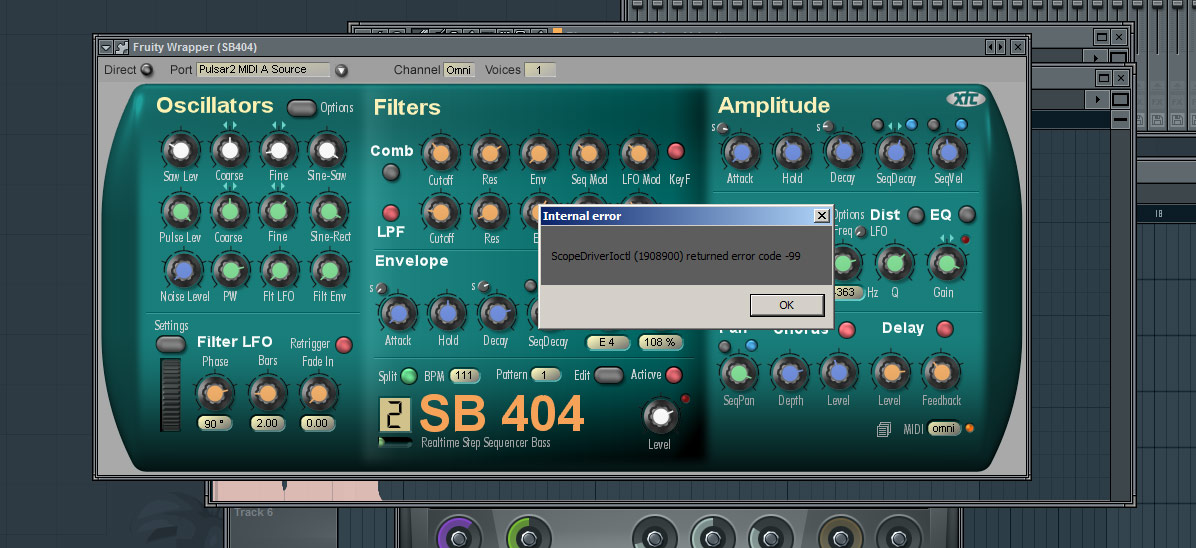

Update: I am attaching screenshot of error which is happening once when i ENABLE all of my cores through windows task manager. note that XTC and SB404 automation worked on single CPU core. As soon as i enable all four cores i get this message and i can only kill application.

mpodrug wrote:Update: I am attaching screenshot of error which is happening once when i ENABLE all of my cores through windows task manager. note that XTC and SB404 automation worked on single CPU core. As soon as i enable all four cores i get this message and i can only kill application.
I get this error at times on playback If HT is enabled. So yes, XTC mode has problems with multi-core or hyper threading. There should be no doubt about this and S|C should not claim otherwise.

I've sent them email today and it seems that they are aware of this. Here is SC response:
thank you very much for the details.
We want to fix this while doing the 64 Bit version anyway.
The bug seems to come from older Microsoft code which was included for
some parts of the Scope 5.0 versions.
Regards,
So..we are waiting in hope :)
