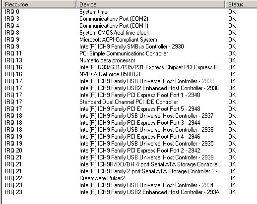

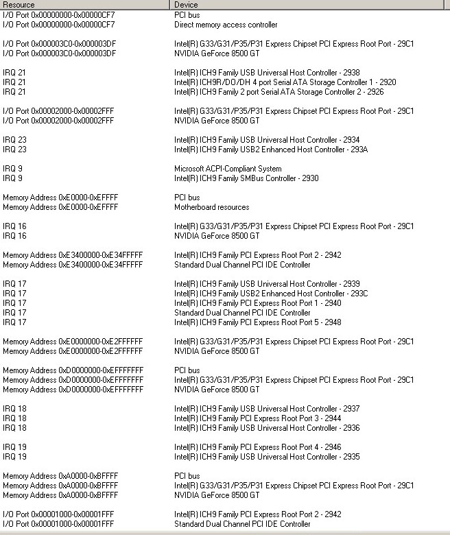

can i install 2 pcie cards? looks irq 1,5,6,7,10,12,14,15,24 are free! or they're using but not seen here!
- conflit - shairing 1.jpg (165.36 KiB) Viewed 1441 times
- IRQ s.jpg (91.21 KiB) Viewed 1443 times

Installing 2 pcie cards will have more to do with the slots available on your board. Whether they conflict will probably relate to what the two cards are.
As for the IRQs, yes most of the unlisted ones are probably being used. For instance, your keyboard is likely using 1, and your motherboard is probably using 2. XP and later OSs don't allow the same control of IRQs as earlier OSs, at least in ACPI mode. That's one of the prices of more or less functional Plug and Play. In addition, most modern motherboards hardwire the IRQ for specific slots, which why garyb recommends swapping slots to find a solution to conflicts.

then, there is likely a usb controller sharing an irq with the card. have you checked?

I must be thinking of a different board and manual, very sorry! I have searched for an IRQ list for your board, but can't find anything that describes the assignments. Here's my suggestions for disabling:
USB #2938 on IRQ 21
USB #2934 on IRQ 23
USB #293A on IRQ 23 (these two alone will open up IRQ23)
ICH9 SMBUS on IRQ 9
IDE Controller on IRQ 17 (I am assuming you only have SATA drives, don't do this one if you are using an IDE cd/dvd drive)
Garyb, maybe you can verify this? I am pretty sure that you can disable all of the USB stuff on IRQs 18 and 19. At some point, you need to leave a few USB ports enabled, but I think that there will be enough left after all of these are shut off.
Don't worry about sharing Scope cards with the SATA controllers. I don't have experience with the other cards you would like to install.
This will get you much closer, possibly all the way to your dream system. I'll say again, IMHO, you won't be able to get all of those things running in a single system at the same time. I'll be happy to be wrong though!

that looks correct, but it's really easier to just put the cards in, find out what is sharing and then disable it. it's really not a big deal at all.
