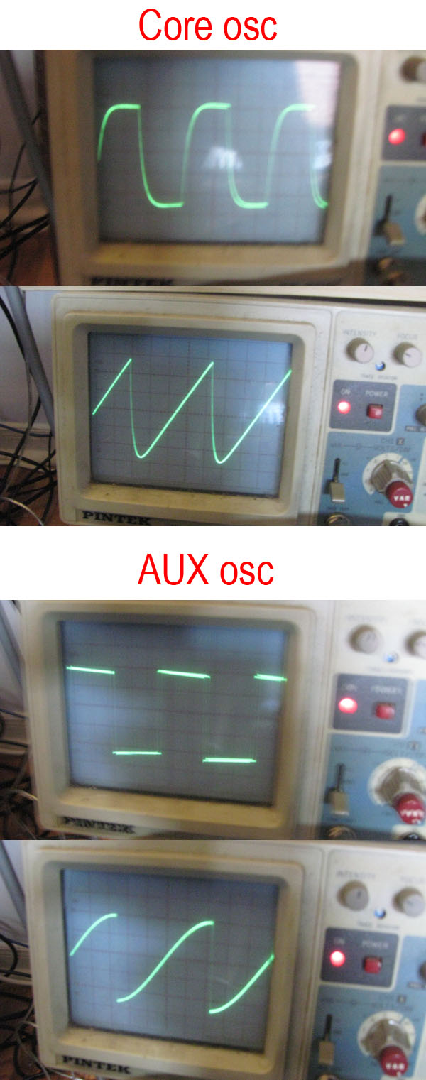

im not sure why the main osc would be filered. the only filter is the actual one in the filter section. i will take a look with ocilloscope this afternoon.Brazda lui Novac wrote:Oh yeah, I love it! Great synth Neutron and great design Shroomz. I tested it for a few hours now and did not find any bugs. Here on 18 DSP's (3+15) i got 16 voices without anything else loaded @44Khz and 4 voices@96Khz. I really like the overtones thing, it's the first time I've seen it on a synth. However I found two strange things, but I'm not sure if this is on purpose, or a bug or I missed something. First thing is that the main oscillators sounds a bit muddy, like they are already filtered a bit. I recorded some waveforms and the square wave and saw wave shape is rounded almost as a sine wave. The AUX oscillator however does sound right. It's a bit rounded also, but less, and it does sound right. I personally always filter the oscs a bit, so it's fine for me, but sometimes you need a spike at the attack which is bright. The second thing is that I could not manage to change the pulse width from the freq/pw pot, but probably I didn't do the right thing, or "pw" is not meant to be pulse width? Anyway, I'm happy with Paradox as it is right know, it sounds lovely, I think you did a great job, and I thank you for that! And great patches Jimmy
pulse width only works when that osc is a square wave and its quite hard to notice at lower frequency on the overtone and when modulated by EGs should be fine with an lfo, ill double check it remember the overtone is muted when the core osc is zero crossing, so if the pulse happens to be very narrow and at the start or end of a core osc cycle you wont hear it.
at higher overtone frq, that wont matter because the overone gets to run more than one cycle before it is muted and reset.

Re: Neutron Paradox Beta and preset making for release.
Yes I know that the only viewable filter is in filter section. Just check with the filter open with no resonance, and after that the aux oscillator. It's pretty clear. I don't know what kind of oscillator you used, you can get the same effect from a morph oscillator from square to wave for example, so it should not be necessarily a filter, it's just sounds like that. Another reason could be (if I remember well) the AUX oscillator is not passing through the filter section and the filter does not open fully...just guessing.Neutron wrote:im not sure why the main osc would be filered. the only filter is the actual one in the filter section. i will take a look with ocilloscope this afternoon.Brazda lui Novac wrote:Oh yeah, I love it! Great synth Neutron and great design Shroomz. I tested it for a few hours now and did not find any bugs. Here on 18 DSP's (3+15) i got 16 voices without anything else loaded @44Khz and 4 voices@96Khz. I really like the overtones thing, it's the first time I've seen it on a synth. However I found two strange things, but I'm not sure if this is on purpose, or a bug or I missed something. First thing is that the main oscillators sounds a bit muddy, like they are already filtered a bit. I recorded some waveforms and the square wave and saw wave shape is rounded almost as a sine wave. The AUX oscillator however does sound right. It's a bit rounded also, but less, and it does sound right. I personally always filter the oscs a bit, so it's fine for me, but sometimes you need a spike at the attack which is bright. The second thing is that I could not manage to change the pulse width from the freq/pw pot, but probably I didn't do the right thing, or "pw" is not meant to be pulse width? Anyway, I'm happy with Paradox as it is right know, it sounds lovely, I think you did a great job, and I thank you for that! And great patches Jimmy
pulse width only works when that osc is a square wave and its quite hard to notice when modulated by EGs should be fine with an lfo, ill double check it
about the key knobd, mr A, yes you are right, i missed that out. oops
I did not expect the pulse width to work with other waveform than square (however this can be done with sawtooth waves on other synths). Now I left the studio and cannot check until monday but I remember I was assigning the freq/pw pot to all LFO's and ENV's and did not hear any change. The change should be pretty obvious, specially in extreme settings. If it works that way then it should be named PWM, not PW. On all synths I know, PW changes the pulse width manually, when the PWM enables the modulating from LFO's, ENV's etc...
the main oscs are a bit "slow" in risetime they are based on LFOs. they need to be because they have to sync start.
so i cant really change it. i noticed on the scope that saw waves have one sharp point, and the other is rounded. with squares the
leading edge is rounded and the trailing is sharp.
anyways if you want perfect waveforms i think you are looking in the wrong place
i was just using the pwm. it seems fine, it does only affect the overtone, which you probably know. and at some settings it will be quite subdued by the edge muting mechanism.
i agree it should be called pwm its on the list of changes for next ver.
As I mentioned before I think it's already a great synth, so your LFO based oscillator does help in my opinion because to me it sounded fatter than the AUX oscillator, so both mixed give a full sound. The only suggestion would be that the AUX oscillator to pass through the filter section too. (I'm not sure but I remember that it does not pass through right now, please correct me if I'm wrong)
I did not expect perfect waveforms in digital domain as I hate aliasing
I just want to know the basic shapes of the waveforms from the synths I'm using. Until now, it helped.
And forget about the classic PWM, there are plenty of synths with that.
cheers,
Victor
