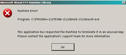

Well !! Not so well ! I can't load mu cubase 5 project now, at the end of its load :
So , I try now with \PAE but I think , it is the same....

So.. When I let \ PAE without \3GB, it is SFP wich won't work : dsp limit reached with an empty project !!!!
I had to let \3GB switch in the boot.ini to load my last (huge) cubase 5 project. But it was crashing at the very end of project load. So I think that when I'll start a new music piece, it will work without \3GB...
Anyway, windows is still seing the 3.25 Go..!
Pfffff..... I'm so lazy to do all this... Restart window + SFP + big cubase project = 4 to 5 mn ! I did it maybe 7 or 8 times !! It's too much for me !!

it is more about motherboard than windows (i have cubase 5 up and running fine too).
just in case, i attach a pic of my boot.ini... no pae (?) or "3gb switch" (3gb switch is known to cause problems like freeze and crash).
i chose my motherboard because there is a specific section in the manual for 4gb ram... i do not know the asus, but if it is recent, it should work.
It also a computer i've built with 4gb ram, and then installed windows... (but i don't think reinstalling windows will change anything, iwould be surprised if it changes anything) check first in the motherboard manual and on the internet for info about your motherboard. on my motherboard, if i don't use 2*2 gb ram, they say it "might not work" (translate: it will certainly not work).
and it doesn't matter if only 3.25 is shown, it means that it takes into account 4gb ram anyway.
PS: cubase5: if you have problems in sfp like pci overflow or dsp overload in empty projects, may be it is because the project is set to 24bit by default after you install cubase5, and the asio drivers in sfp do not match. here it works (i use 24bits in cubase5 all the time now), but it takes a bit more ressources than 16bits (and i use "asio2 16 bits source" and "asio2" dest). may be that's a clue.
It can also be a "bad plugin" but i'm not sure of that, but runtime errors in cubase are more often caused by plugins, more than by something else (which is possible too, but i don't think it is ram in itself).
