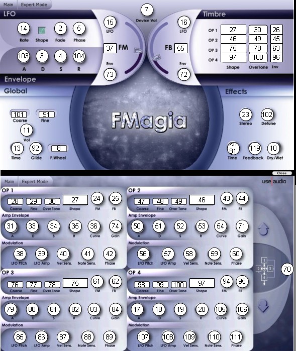

One small extra for thoose interested by the FMagia :
Plugiator FMagia CC+PaT midi map
CheerZ

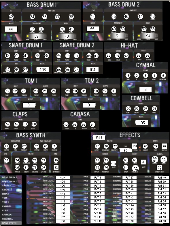

by HUROLURA
OK here is the Drum'N'Bass
Plugiator Drum'N'Bass CC+PaT midi map
CheerZ

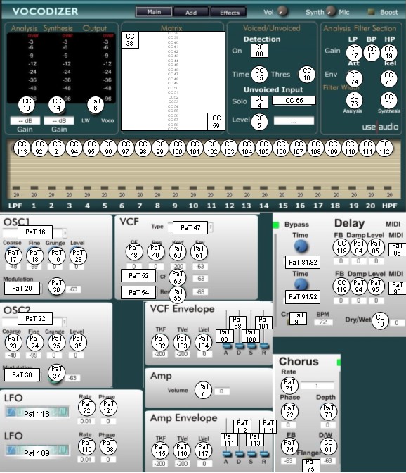

... and here is the Vocodizer
Vocodizer Plugiator Midi CC+PaT map
