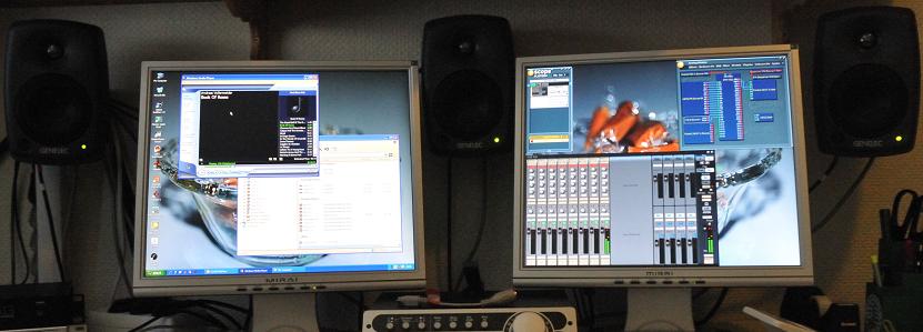

I added a wave source to the Scope project i've been using, and have played Mediaplayer for a long time now, and keep it playing some more hours.
