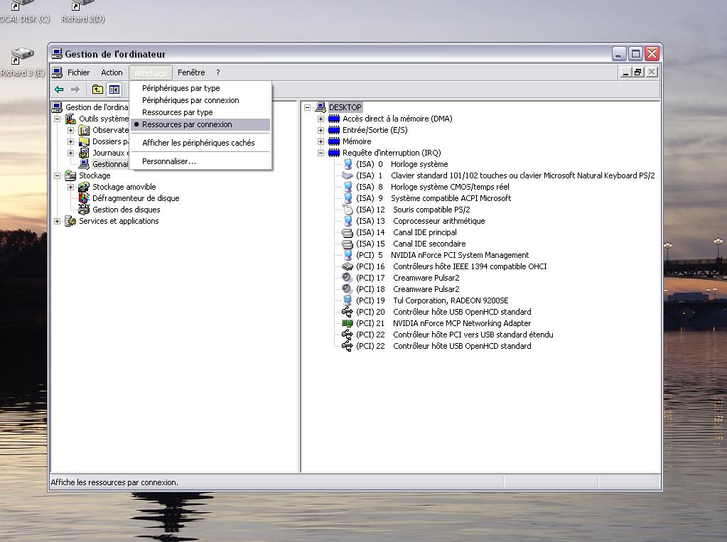

It sounds very much as if your pulsar's on the same irq as the Graphics card.I've got a radeon with a firewire card I don't have any problems at all ?
