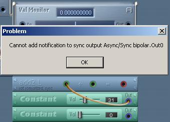

i did some testing:
something is strange to me:
A2Gate ... value ? can not modifie this .. should this be possible for
labeling ?
math
add2L ... cann not connect to const value modules .. see picture

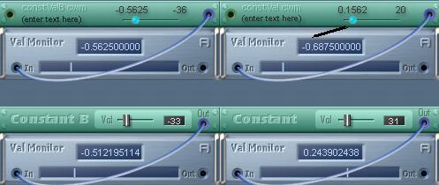

constVal should send 0 to 1 and not -1 to 1 ..see pic .. module has the same behaviour as the constValB

i did some testing:
labeling ?
math

- add2l
- add2 L.jpg (14.9 KiB) Viewed 9651 times
- constVal
- const value prob.JPG (22.64 KiB) Viewed 9653 times
- rangetoVal
- hmm.JPG (16.04 KiB) Viewed 9653 times

this is a text fader to switch between "value" and "signal" (click on it and move it up or down)widy wrote:something is strange to me: A2Gate ... value ? can not modifie this
mh, I can't reproduce this. But the module had a bug in computing the sum of the two inputs (fixed)widy wrote:add2L ... cann not connect to const value modules ..

fixed!widy wrote:constVal should send 0 to 1 and not -1 to 1 ..see pic .. module has the same behaviour as the constValB
the output don't show up in the Flexor ValMonitor modules, but in the cwm ValMeters, for (to me) unknown reasons.widy wrote:range2Val i dont unterstand this module
