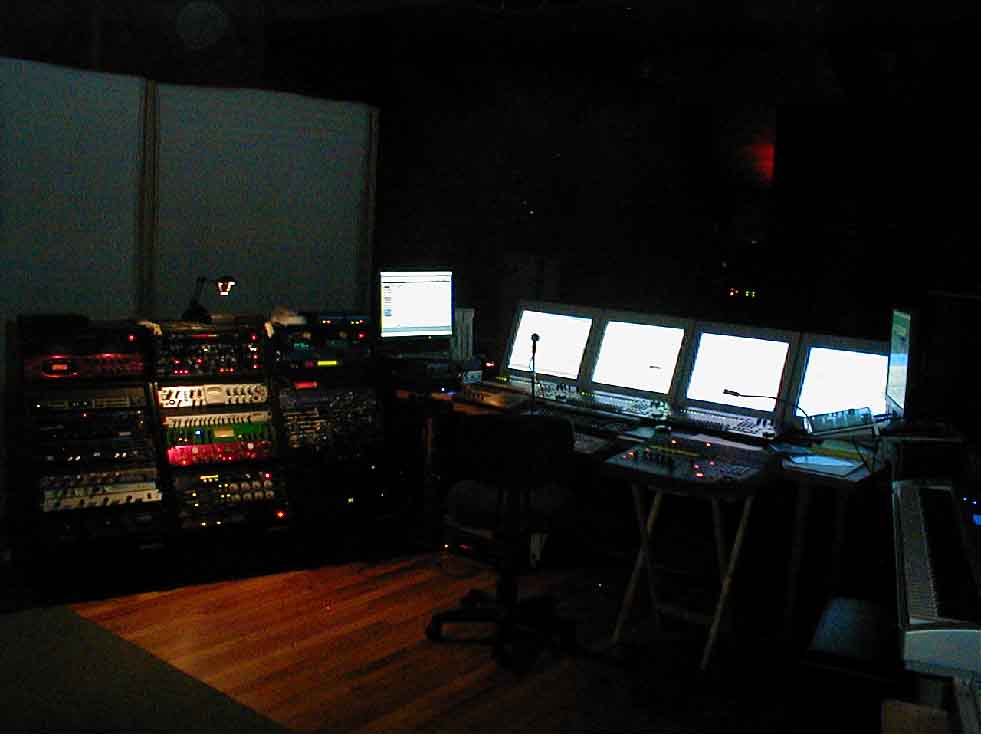

I have become a bit sicker overnight. It's been getting cold here in the frozen mountains, my hut has become uncomfortable and the dogs have invaded my bed to stay warm so I need more CRT monitors. I just scored a 4 head Colorgraphics Xentera AGP card that I am going to try to integrate into the Pulsar DAW. Since I'm running 4 x displays on the Paris rig and only two displays on the Pulsar rig, I've decided that if it is possible to have two more CRT displays on the Pulsar rig and I don't do this and therefore achieve 8 x displays, I might freeze to death or be suffocated by puppies.
