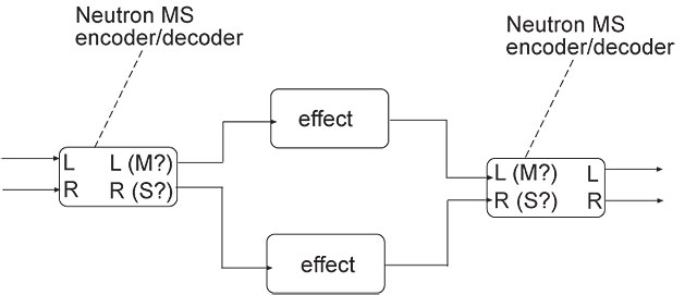

Re: mid side encoder/decoder
Could anyone says to me if this routing is correct for this plugin usage?
Thanks in advance
Thanks in advance
- question-MS.jpg (19.67 KiB) Viewed 2253 times
That looks right. if you put effects only on the s channel iit works on the "stereoness" and m works on the common signal.
