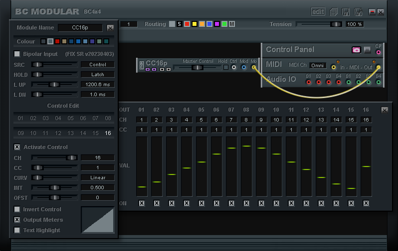

				CC16p FIXsr |MODULES #Spielraum
				Posted: Thu Apr 06, 2023 1:41 am
				by Spielraum
				CC16p fixed +extensions
your task: find the easter egg password in this post
# Master Control / BC-Pipe 16 Channel to 16 Midi CC
+ Select Input and Source fixed (tested in Scope v4-7)
+ BC-Pipe Offset 1~8, 9~16 (32Bit uni) purple
+ BC-Pipe Monitor 1~8, 9~16 (32Bit uni) white
Examples:
# Midi Remote Organ Drawbar or Mixer Fader Group eg., take BC-Pipe Offset 32Bit uni for Channel Fader and Master Control as Group Fader
# Master Control Async/Sync smooth to BC-Pipe Monitor Value 32Bit uni
# direct Convert BC-Pipe Monitor Channel 32Bit uni to Midi CC 7Bit
... for a better workflow in S|C Modular ...
a Triubute to Sharc Simon + Dawman Jim
thx guy`s, will see you in heaven, Love You!
- easterinpeace
- #CC16p-FIXsr_20230403a01-Overview.png (86.11 KiB) Viewed 101077 times

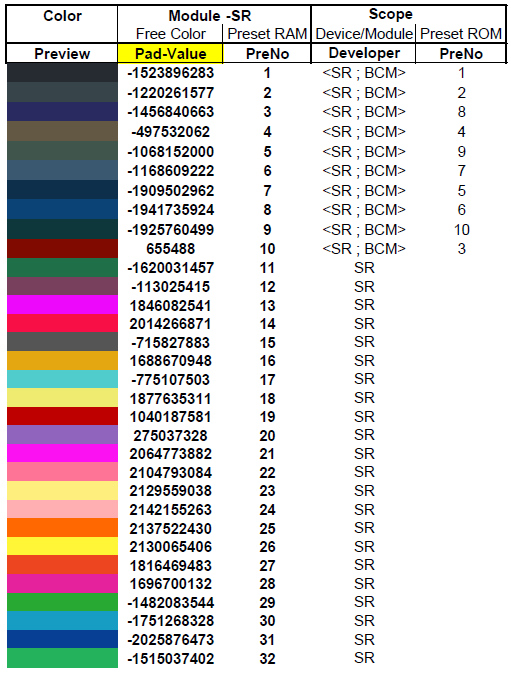

				Label3a |MODULES #Spielraum
				Posted: Sat Jun 03, 2023 4:12 am
				by Spielraum
				Label3a free
# easy Label module
+cascade engine
+today, my B-day, and i want to give you presents
- 4U on my B-day
- #Label3a-SR-20230514a01.png (4.73 KiB) Viewed 99932 times
#Tutorial: how work the Textstring Engine
connect the lightblue Module Pad "Strg" with other SR-modules with this TextEngine (cascade)
Now press the button "Write Mode" when you will send/receive Textstring.
the last activated button will send his Textstring to the connected modules.
after activate all "Write Mode" buttons, you can write in one module and will see the result in "mirror"-module
(this engine is also for future module but you can try it now in your MODULAR shell.)
#Tutorial: how work the Color Presetbank
select a preset: click on the red number, hold mouse and move up/down
you can save your own Color in up to 32 User Presets
connect the white Module Pad "Free Color" with a Fader, Knob e.g.
now select a Preset and see the color value.
move the controller and find your favorite color, or tipp in the value in a connected Textfader! (see FreeColorChart-SR-20221224a2.pdf)
is the result in your Presetbank, the Presetnumber [1~32] will show.
is the result not in your Presetbank, it will show [X]
Now press the button "Write Color", the Preset logic ist activ!
select your final Presetnumber and send with yor connected Controller your Color Value!
Repress "Write Color", for permanent save!
You can all Presets change in realtime when "Write Color" is activ
finally, combine other SR-modules with this ColorEngine (cascade)
#Free Color Sheet
- Spielraum ' 2023
- FreeColorChart-SR-20221224a2.png (57.39 KiB) Viewed 99932 times

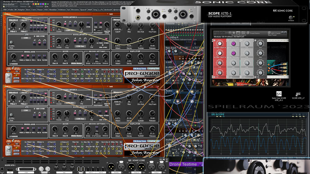

				25yrs SCOPE |MODULES #Spielraum
				Posted: Sat Aug 12, 2023 11:03 am
				by Spielraum
				HAPPY BIRTHDAY SCOPE DSP FARM [08.1998 ~ 08.2023]
auf die nächsten 25 Jahre, three cheers!
Spielraum Ambient Drone Jam Session called "ZARG" morning
Recorded: 12.08.2023
Modular Blockbuster Ambient Drone, like John Bowen Synth Sound!
youtube >> SC-ModularSR-ZargProWave-Drone-Spielraum-20230812
- Zarg Pro-Wave Hans Zimmer Edition
- SC-ModularSR-ZargProWave-Drone-Spielraum-20230812-1000.jpg (206.05 KiB) Viewed 97384 times

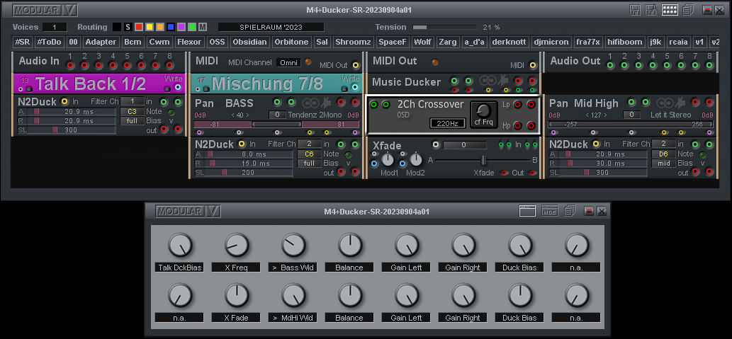

				Ducker |MODULES #Spielraum
				Posted: Mon Sep 04, 2023 7:19 am
				by Spielraum
				Ducker/Gater free
# easy Duck/Gate module (Midi Trigger)
+Attack/Release
+Slope
+Bias/Intensity
+Midi Channel Filter
+Midi Note Define
+Midi Note Velocity to Intensity
- make music, not war!
- #N2Duck-SR-20230904a01.png (9.96 KiB) Viewed 96852 times
#WORK with Ducking module
Attack, Release, Slope Curve and Bias
control can be used to scale the incoming Midi Note Velocity,
so the velocity curve of the Midi data can be recalibrated to some extent
Tip: with full Bias and Max Velocity you have a classic Midi Gater for your next Trance,Ambient,Glitch Production.
Or take it to remake a great Phil Collins Snare Room Gate
 #MODULAR IV StartUp Patch
> Line 1/2: Talk Back Ducker/Gater
> Line: 7/8: Music 2Frq Way Ducker
- StartUp Patch
- M4+Ducker-SR-20230904a01.png (134.12 KiB) Viewed 96852 times
#STUDIO Basics
de-emphasis of background disturbances, while 'Ducking' mode - normally a feature for voiceover work - can also be used creatively to deemphasise audio which might cloud a mix when there's too much going on.
Ducking is a process is used extensively in voice over production: essentially the level of one audio channel controls the attenuation of another, so it is a good mechanism to automatically reduce the level of music while someone speaks – typically a radio DJ talking over the top of a background track.
However ducking can also be used creatively to give extra prominence to a particular track in a mix, or to de-emphasize effects which might cloud a mix when there`s too much going on. For example, within a busy mix a vocal track may control the subtle ducking of a guitar track to gently aid the distinction of the voice. Or a vocal track with heavy reverb can be used to control the ducking of the reverb effect on a guitar track, so that the two reverb effects do not clash within the mix.
Many years i take my Alesis 3630 to make Daft Punk Style House Rhythm, with Kic and Bass PingPong Ducking
Now you can check my StartUp M4 Patch in Folder "Patches" ...
Spielraum ' 2023
