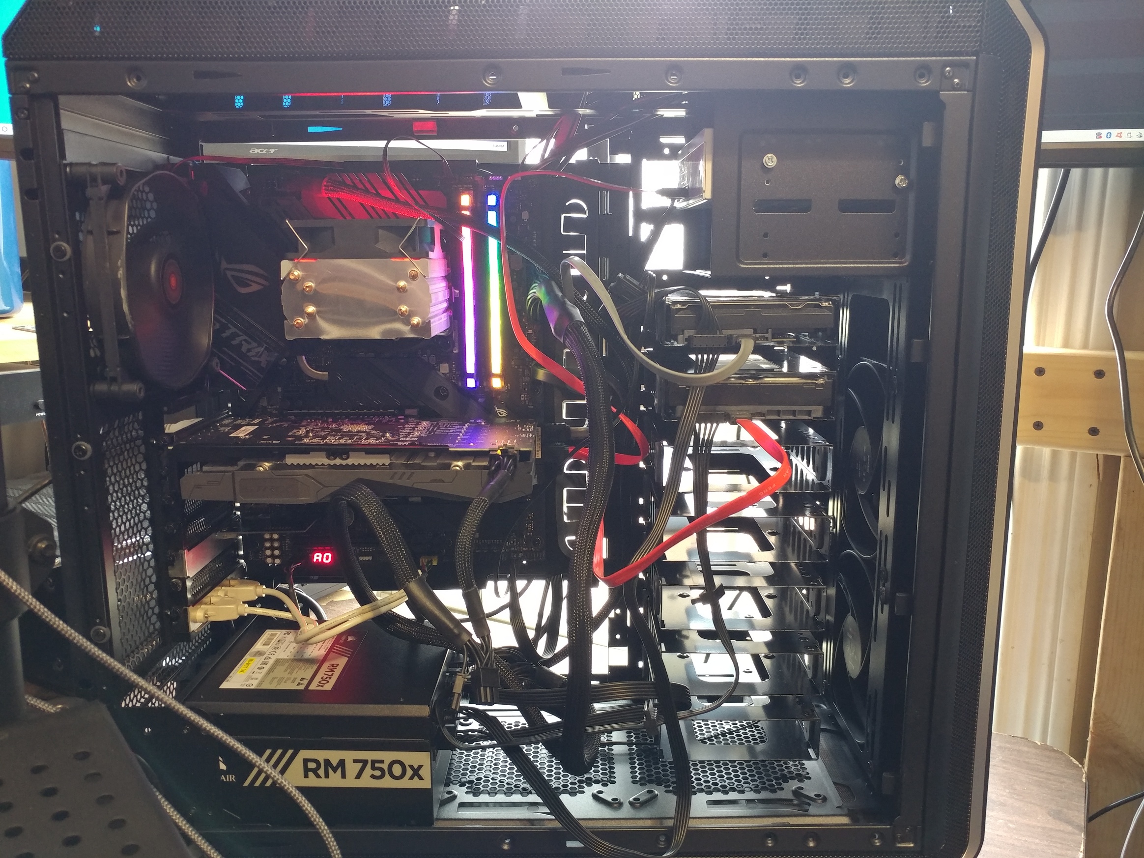

				Here are the specs on my new computer. (very similar to Katano's build)  Still testing but appears to be working just fine with Xite-1.

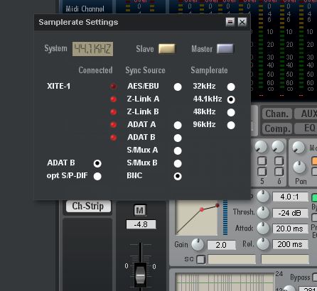

The only snag was when I put the Xite-1 PCIe card in 1X slot #1, the BNC would not sync to the master clock.  When I moved it to 1X slot #3 it synced up just nicely.  (I think the fist slot has different specs than the rest)
Also a very strange noise seems to be coming from the computer thru the Xite-1 PCIe/HDMI cable to Xite-1 XLR outputs.  (Confimed it was not going internal by checking via the Xite-1 headphones out and no noise.)
It is barely audible but noticeable when I crank up the volume on my mixer all the way.  Sort of scratching noise when the hard drive is accessed and even when I move the mouse although to a much less degree.   When i play an instrument at a normal volume I do not even hear it and as long as it is not recorded I suppose it really isn't worth troubleshooting but thought I'd post it here for folks.
ASUS ROG STRIX Z490-E
Intel Core i9-10900K 10-Core 3.7 GHz LGA 1200 125W BX8070110900K
CORSAIR Vengeance RGB Pro 32GB (2 x 16GB) 288-Pin DDR4 SDRAM DDR4 3200 (PC4 25600) Intel XMP 2.0
ASUS ROG Strix Radeon RX 570 DirectX 12 ROG-STRIX-RX570-O8G-GAMING 8GB 256-Bit GDDR5
Sabrent 2TB Rocket 4 PLUS NVMe 4.0 Gen4 PCIe M.2 Internal SSD Extreme Performance Solid State Drive R/W 7100/6600MB/s
be quiet! DARK BASE 900 ATX Full Tower
Corsair RM750X PSU
Windows 10 Pro 64-bit
WD Easy Store 10TB external USB and a couple of SATA hard drives from my last computer.
Oh yeah, one last thing if you are looking at these ASUS Z-490 ROG Strix motherboards.  Be careful of the heat sink you buy because the CPU slot is very close to the RAM slots.  I had a new heat sink sitting on my shelf that I installed and the mounting brackets extended out over the first 2 DIMM slots.  I was able to bend the wing clip off to use the second DIMM slot but I have a water cooler heat sink on the way in case i want to utilize all 4 DIMM slots.
-Also  If you are installing one of the new NVMe SSD's on this motherboard, there is a preinstalled heatsink and on the underside is a thermal layer with a plastic strip on it for protection during shipping.  Make sure you peel that plastic strip off.  I did not since there was no instructions that told me to to so but for some odd reason I decided to double check and luckily averted a possible thermal condition episode.
Whew!
Prefabricated back panel of the motherboard is a nice feature and seals it up perfectly w/o having to fiddle with those old metal cutouts.
- Newcomputer.jpg (1.29 MiB) Viewed 351677 times
				Re: XITE-1 PC CONFIGURATION REFERENCE
				Posted: Wed Dec 30, 2020 11:28 am
				by katano
				nice!
				Posted: Wed Dec 30, 2020 11:37 am
				yayajohn wrote: Wed Dec 30, 2020 10:53 am
... when I put the Xite-1 PCIe card in 1X slot #1, the BNC would not sync to the master clock.  When I moved it to 1X slot #3 it synced up just nicely.  (I think the fist slot has different specs than the rest)
Ooops,- I thought BNC Sync is broken in SCOPE v7.0 (x64) ...
Which SCOPE version do you use ?
That´s not normal IMO,- at least I don´t have that w/ the older PCIe card using DVI to HDMI connectors.
Did you try a different HDMI cable already ?
Corsair RM750X PSU
Great specs and looks great too.

				Hey Bud.  Not sure about the BNC.  I think it is broken if you want to use the Xite as a master clock.  Mine seems to work in slave and yes it is Scope 7.

				yayajohn wrote: Wed Dec 30, 2020 2:53 pm
Excellent news !!!
I didn´t try because I might have misunderstood somewhere here @PlanetZ some time ago.
Now I will, because I want all the digital gear be slaves, except the masterclock I bought.
Thx for the pic and ...
