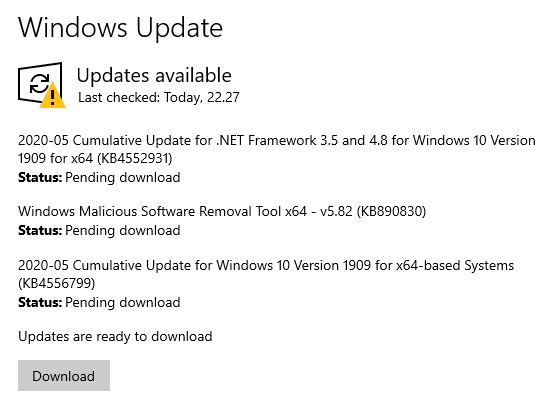

Seems like the newest cumulative Windows updates that Microsoft rolled out yesterday Tuesday have solved my problem with random clicks (Still holding my breath!!!):
ClickFree Updates.png (22.88 KiB) Viewed 43142 times
I wonder what it is in this update, that fixed the random clicks (still holding my breath)?
I'm now able to get lowest ULLI with the XITE on light projects, but I have to run my PCI cards at 13ms to achieve clickfree operation.
If I tax my system but keep it under 50%, I have to raise the ULLI to 4ms on the XITE in order to keep it click free. But the clicks I get are not random.
If I tax the system even further to 50%+, I have to raise the ULLI to 7ms on the XITE in order to keep it click free. But the clicks I get are not random.
I will report back after I've run a few more tests.
