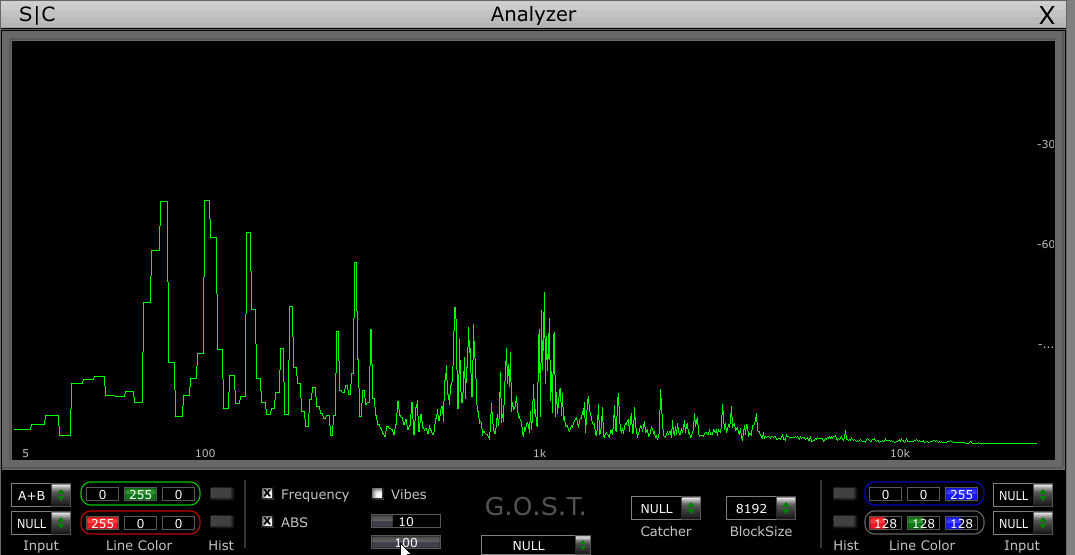

maybe this helps a bit for understanding:
filterbased analyzer:
take a lopass a hipass a bandpass;
put a VU meter at each of the filterouts;
and you have a 3 band analyzer;
you can imagine that the frequency separation depends much on the quality of the filters used;
most of them show on a lo signal outputvalues in the high vu;
course the stopband does not stop fully;
in fact convolveQ is the only scopefilter being able to drop the stopband into the non hearable area;
but still there are some values;
so low frequencys show also in the hipass and bandpass and add up there with the high contend;
fft analyzer:
using the Fast Fourier Transform you save computation time by the powers of 2;
basicaly_
audiosamples are collected up to the framesize (fft_blocksize)
than a FFT is made;
the result are (fft_blocksize/2)+1 magnitudes;
their freqeuncies (BIN frequencies) are determined by (samplerate/fft_blocksize)*binnumber
so for a fft_blocksize of 1024 at 44100 Hz you get
BIN_0 = sr/fft_blocksize = 44100/1024 = 43.06640625 Hz
BIN_1 = BIN_0 *2 = 86.1328125 Hz
BIN_2 = BIN_0 *3 = 129.19921875 Hz
and so on;
so the output is linear__
up to
BIN_0 * 512 = 22050 Hz = sr/2;
the frequency resolution is 43.06640625 Hz
now if you stretch this linear values in a 1024 pixel display log type;
you get the left 1/3 of the display about 5 valid measurement points;
whereas on the rightmost display each pixel collects a cuple of binfrequencies;
the idea of the fix Hz scale was to show a log display up to the fundamental area
by streching the display in the high end to show more valid measurement points;
the hidden fader got a value per fft_blocksize from a logic;
the range was set to fit these needs;
now you are the logic;
it is possible to reach a full log scale at each fft_blocksize but . .
only at 1024 you have the full range from lin to log__
at 8192 as shown in the pic of dante its more a log to log overstretch__
so its no good example;
but i will make 4 different ranges for the updaterelease;
+ maybe a doubleclick for setting back to log type;
now if you take 1 bin the normal display shoes the magnitude and its phase vs the fft_blocksize;
never seen in any other analyzer btw.
you see it rotating around zero right;
if it has a fix value its phase is constant to the fft_blocksize so it must be a binfrequency;
OR you have catched the input;
now if you increase the Hz input you see it rotating - spread over 2 bins and finally showing up on the next binfrequency;
the distance is 43.06640625 Hz at 44k1 1024 frame;
if you take 2 sinus you can see its phase to each other vs the fft frame;
catch one to get their relation to each other without rotation;
this is very simplified;
i hope no scientist beats me for simplifieing;
there should be lots of info about ffts around just do a search if youre interested in;
this topic fills books you know;
no more time right now vibes
