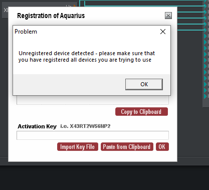

Don't know if this was already reported (seems to be a very old bug - see here for example: viewtopic.php?p=298721#p298721).
When you want to register a new device and don't have the key yet, you're stuck in a loop and have to force quit SCOPE, because the registration window keeps coming back again and again.
