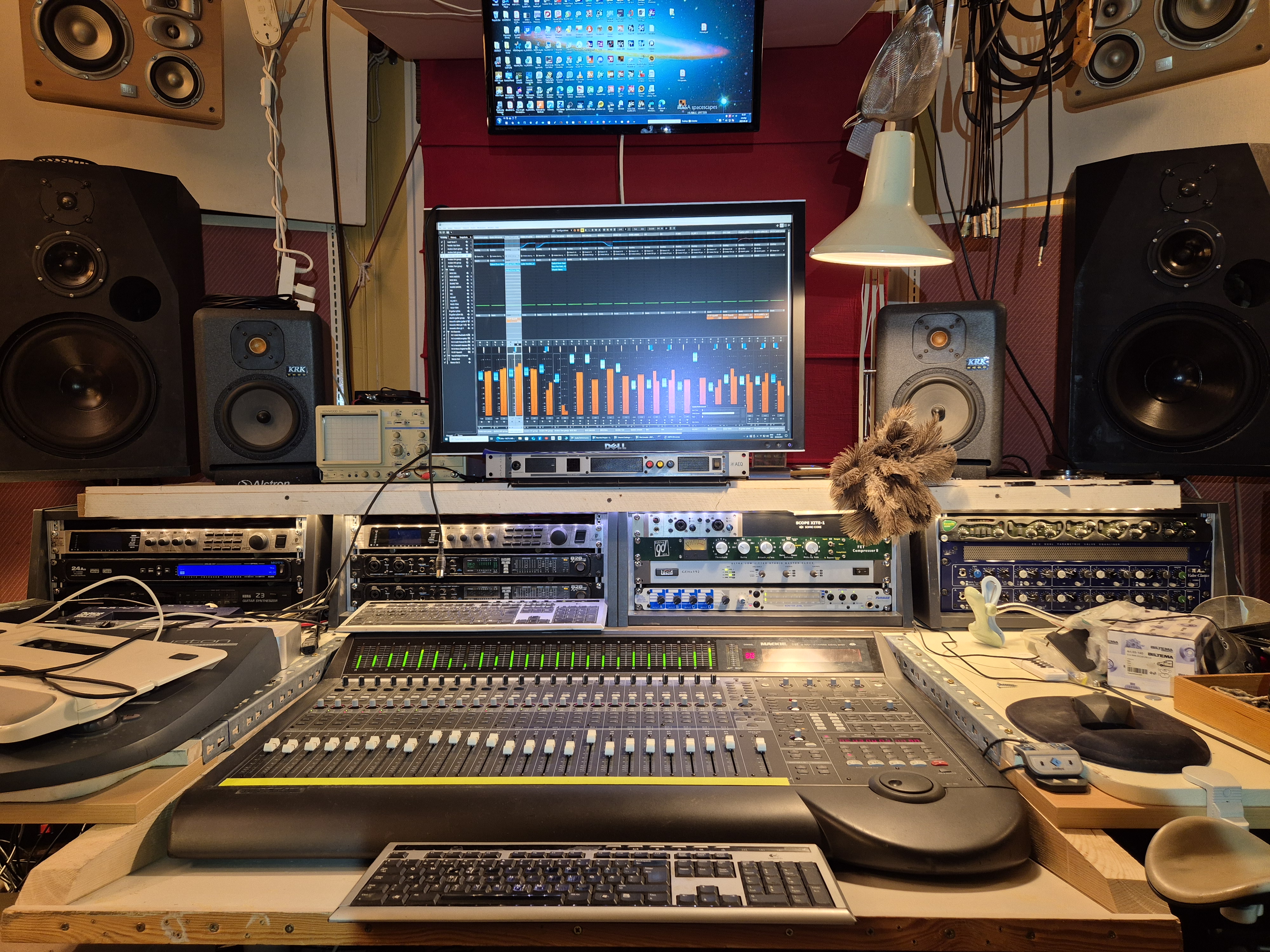

pics or it didn´t happen ! :D
I didn't manage to pay the guy before recently.
But now it is newly cleaned and set up to go.
Already tried it out on a Lenovo Thinkpad T530.
Worked with Scope v5.1 on Windows 10, after some finicky driver installing. How do I upload the picture? :o
Ok. So I found out. :-)
Posts: 7747
Re: New on Xite-1
Looks good! Miss that Mackie mixer...

valis wrote: Fri Sep 26, 2025 6:17 am Looks good! Miss that Mackie mixer...
Thx. Actually not using the digital i/o'ts, preamps, or plugins. Only as a kind of bigknob monitor controller, and 24 channel daw controller via probox. I love the hands on feeling and the lessend mouse addiction. :)
Posts: 7747
Re: New on Xite-1
The low end is better in Scope mixing and your DAW. A good cheap control surface though in this era, for anything with HUI support. Agreed.
