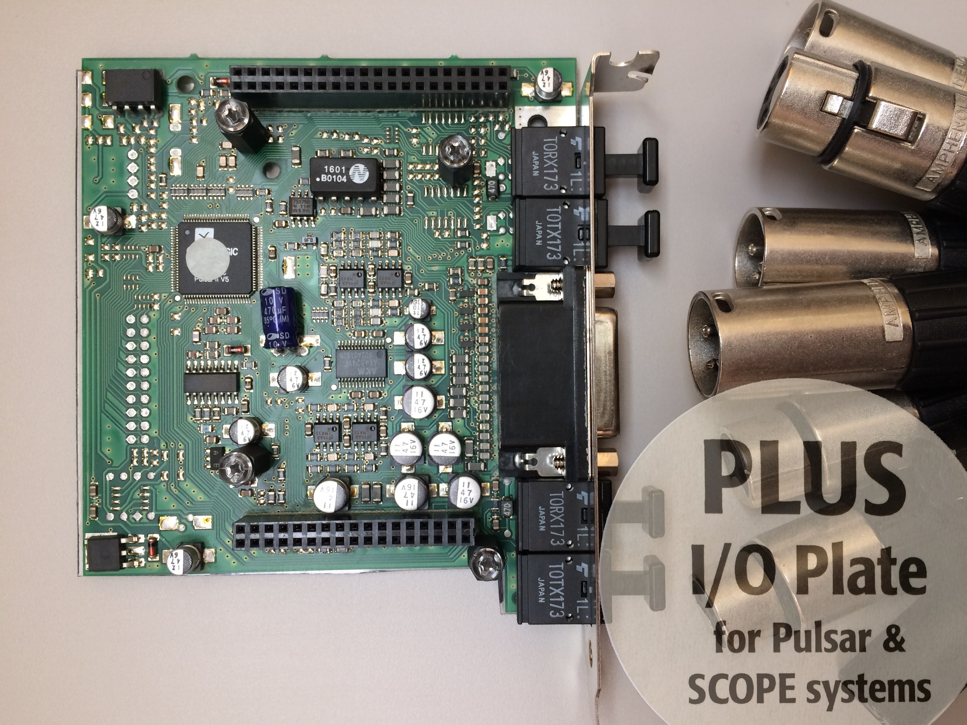

To identify an I/O Plate you can use the following picture of a Plus I/O Plate for comparison.
The Plus I/O Plate comes with some additional chips and caps.
The most noticable chip is the big one labeled 1601 (near the top of the photo).
There’s another photo with both I/O plates side by side in this thread. It’s somewhat blurry, though.

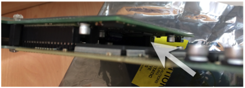

You actually don’t have to unmount the I/O Plate from the card to identify it.
Just have a close look at the right spot for that 1601 chip.
Maybe the following picture gives a rough idea how and where to look.

Re: How to identify the I/O Plate (Classic vs Plus)
yes, the extra ic is for balancing the signal.

asktoby
Posts: 211
Joined: Thu Mar 13, 2003 4:00 pm
Post by asktoby »
Here's a photo of the other sort of IO plate for comparison (albeit with replaced capacitors)
