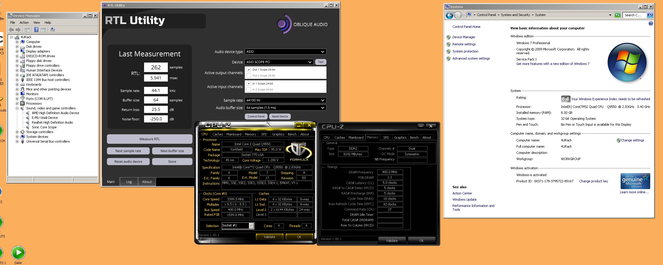

Just been having a look at the Scope Pro card a bit more closely regarding the round trip latency - If the sample rate was raised to 96 Khz in ULLI settings, does this reduce the input track count by half? - I know at some point this does happen but does it happen at 96 Khz on Scope Pro running 5.1 software? - And then there are 8 ins instead of 16.
It seems to be possible to get 5.9 ms round trip latency at a buffer of 64 - attached is a JPEG of this - I was hoping it may be possible to up to 96 Khz (thus halving the RTL) but not if it halves the track count.

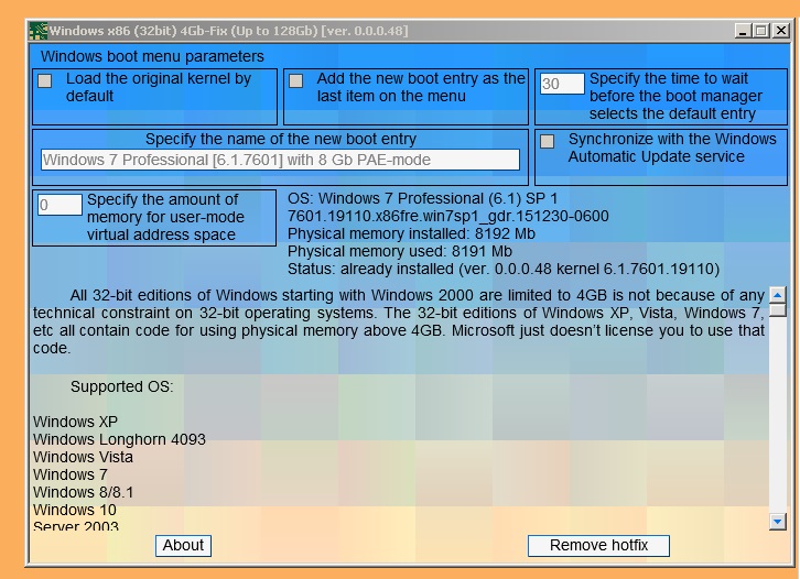

PAE patch has been enabled and it works - but it did not work on EMU 1212M (PCI) nor did it work on Focusrite Saffire Pro 26 (used_&_cheap)

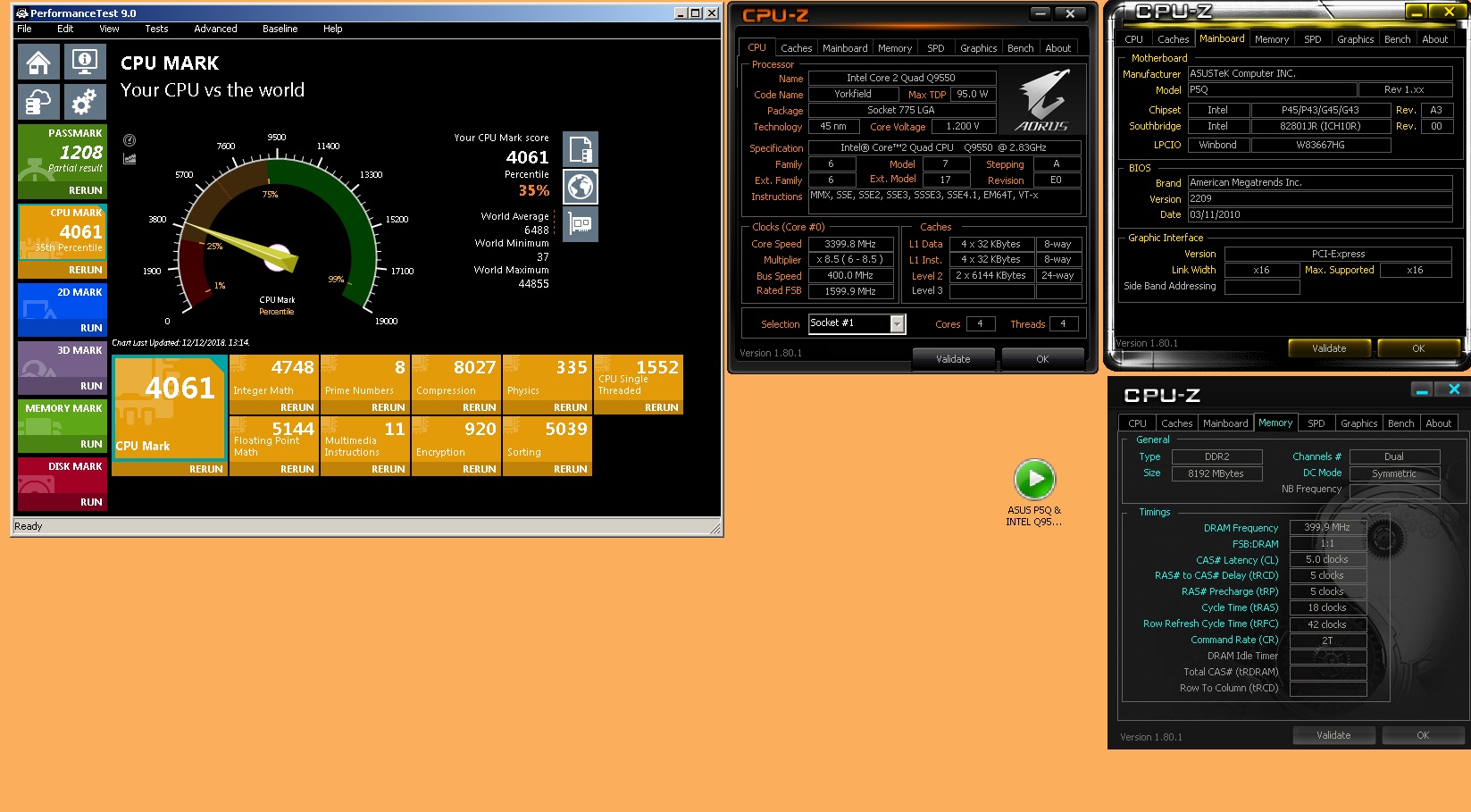

This is an old 2008 board Asus P5Q & Q9550 OC'd @ 3.4 Ghz - Which is imaged to Macrium Reflect Free! - Just in case anything happens to the installation it can be reverted from an external backup.
This is about as good as this machine can be! - But it does have some older software on which cannot be activated anymore courtesy of Native Instruments.
Even though the CPU power is not like a 4790K - It was necessary to get the OS as good as possible for use of it's potential - Any useful info is welcome - Thanks -If this forum is still working!
OBLIQUE RTL LATENCY IN OUT #2.jpg (429.97 KiB) Viewed 16900 times
PAE PATCH JPEG.jpg (149.94 KiB) Viewed 16900 times
