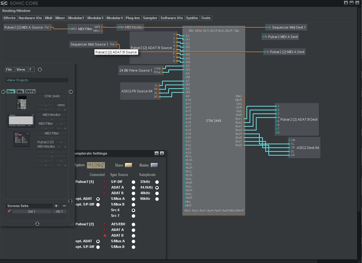

3 Scope Project cards (1 is a booster) Windows 10 64bit Scope PCI v7
My DAWs are not showing any Scope MIDI ports. (Reaper/Ableton)
1. Sequencer MIDI In/Out modules are loaded in the project window before start.
2. MIDI devices are set at Device Manager under "settings"
3. The physical I/O MIDI connections are working.

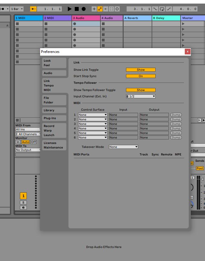

Ableton has to be run in compatibility mode for the Scope ASIO as well I believe, and I don't use Reaper so not much help there.
Surely you know how to enable midi within Ableton, can you post a screenshot of the midi/controller page just in case?
Posts: 1731
Re: No Scope PCI MIDI in DAW
valis wrote: Sun Sep 03, 2023 9:10 pm Ableton has to be run in compatibility mode for the Scope ASIO as well I believe, and I don't use Reaper so not much help there.
Not true from my experience. I have Ableton running on Win 11 with my Xite and it has been working great.
I would be inclined to pursue that the DAW might be the issue except to me it is not likely since I am getting the same behavior with 2 seperate DAWS.
Project Window.JPG (96.75 KiB) Viewed 8378 times
