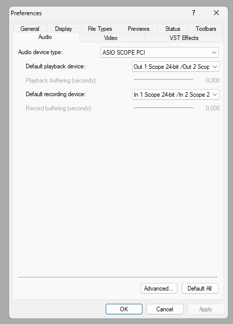

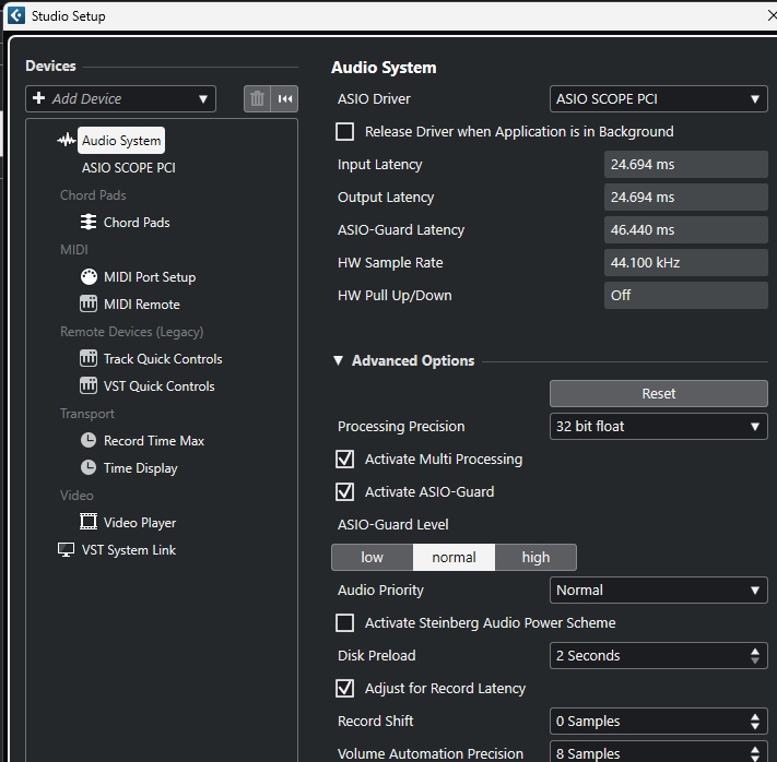

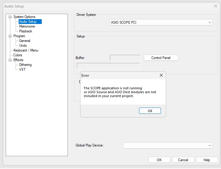

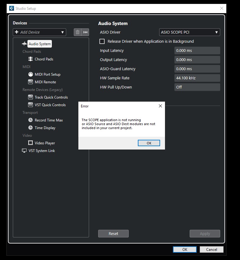

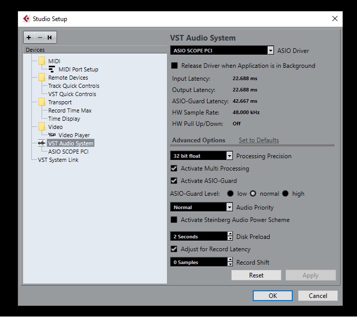

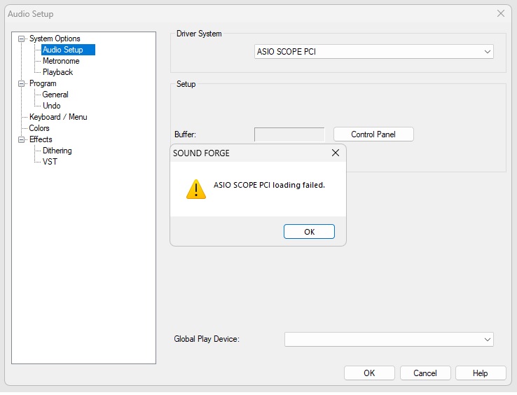

update :
today i installed Win11 Pro also on this machine and tried once again, but results are exactly the same.
Cubase Elements 9.5 and Sound Forge Audio 10 recognized ASIO right away
Cubase Elements 12 and today I also tried my second version of Sound Forge Audio Studio 12 and ASIO is not recognized.
Not sure, what's with this number 12, lol
Pictures are first 2 from Sound Forge Studio 12 and last from 10.
fidox
Posts: 850
Location: Slovenia
Re: ASIO not loading with Cubase Elements 12
Post by fidox »

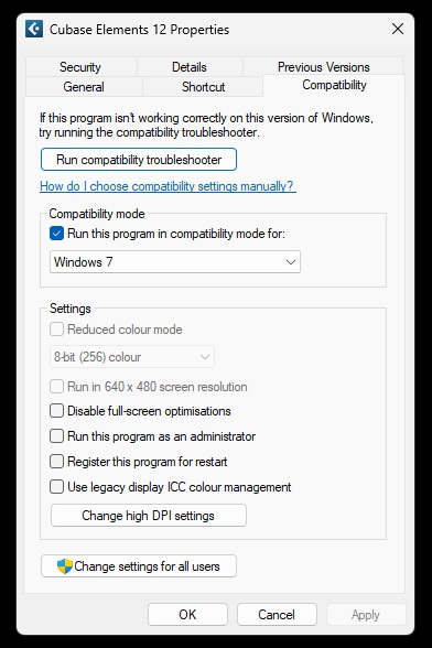

Update :
It works !
I tried it by chance, ASIO recognized.
Also works with compatibility mode for Windows 8.
Windows 11 Pro 64bit, Scope 5.1.
Posts: 2930
Above it says Win 7 compatibility mode.
Is the reported latency the lowest possible on your system ?

Bud Weiser wrote: Fri May 12, 2023 1:24 am Above it says Win 7 compatibility mode.
Yea, but it also works with Windows 8 compatibility option.
On this slave machine (win11,scope 5.1)is fine, cause i'm running here just vst's over adat to my master machine (win10, scope 7) in sync with 2 sequencers running.
No, latency can be lower, this is just my default scope startup project.
