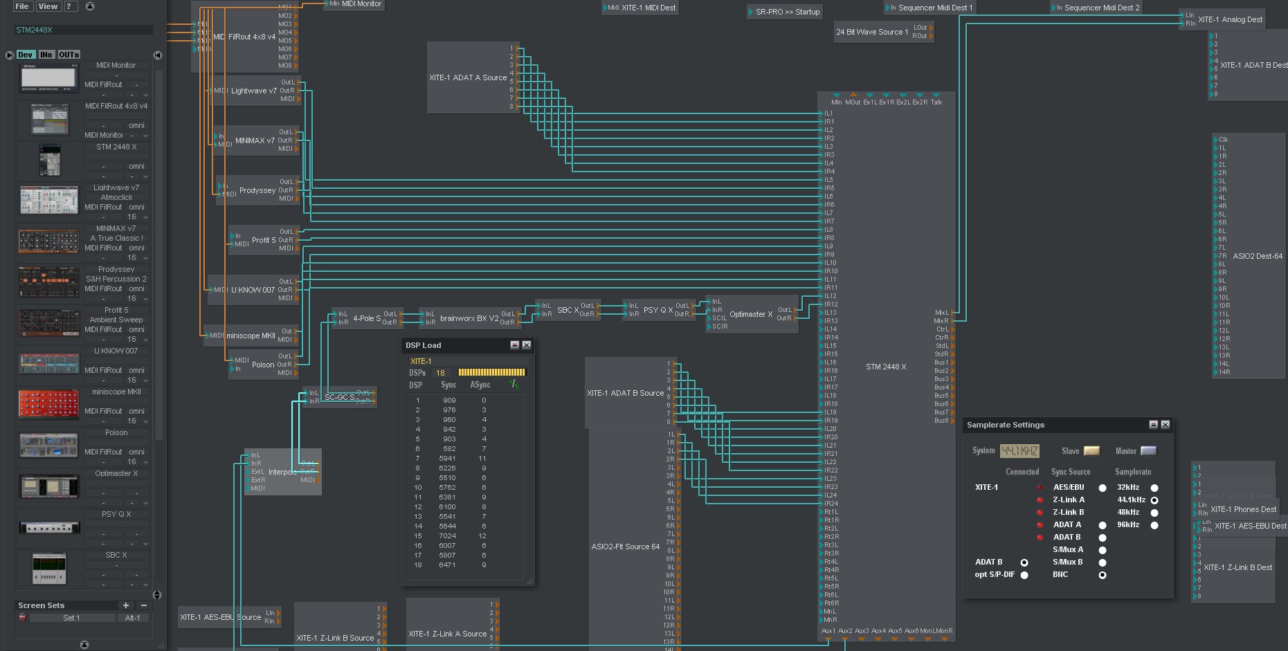

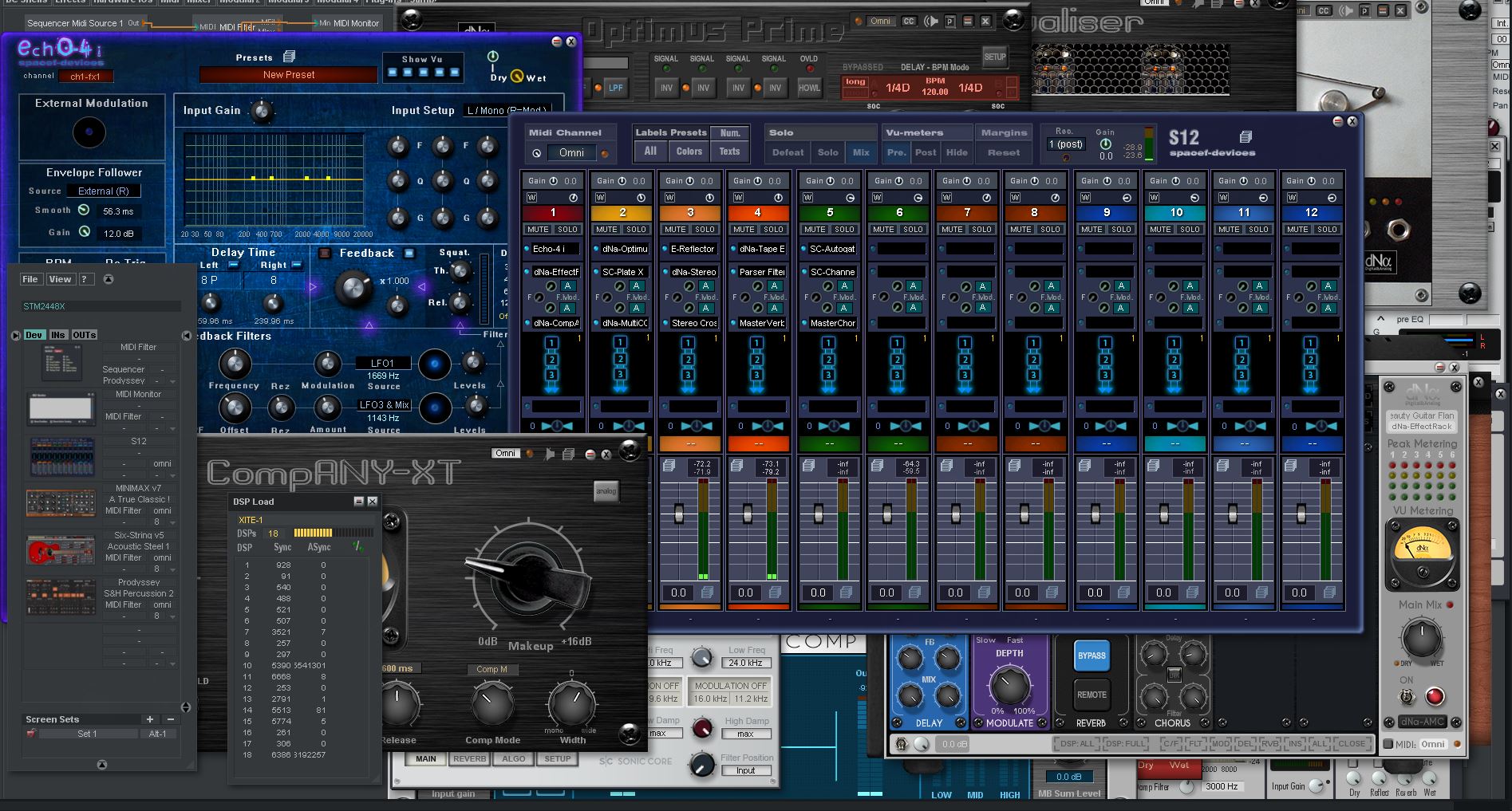

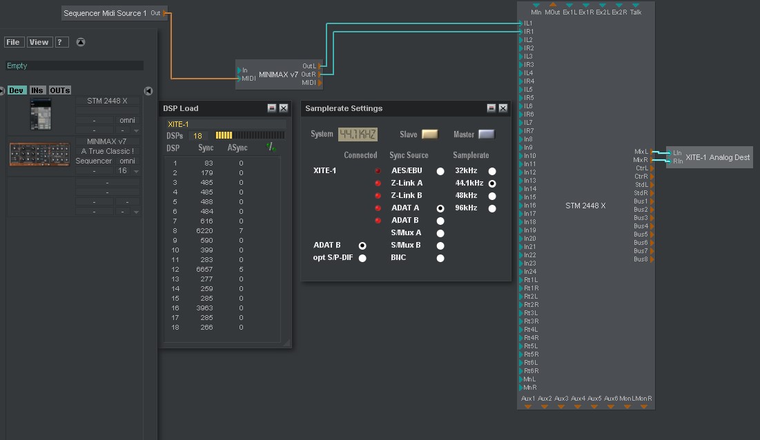

Did you try it Bud? I hit my DSP limit at about 7-8 all at 16 voices and the rest were less.

"I hit my DSP limit at about 7-8" means what ?yayajohn wrote: Tue Aug 30, 2022 3:57 pm Did you try it Bud? I hit my DSP limit at about 7-8 all at 16 voices and the rest were less.
7-8 segments on the vertival DSP meter or,-
only DSPs #7 and #8 reach SAT connection limit (Async 100%) while the other DSPs show less than 100% Async?
I will try the test once I got more details from you (also see below),-
So, you say:
Load all the stock synths coming w/ Scope v7 as also optional S|C synths,- ProTone, Prodyssey and Sixstring,- at the same time, then maxing out voices ´til the cows come home ?
Which I/Os and mixer are in the project and been loaded 1st ?
Did you wire synth outputs to the mixer inputs (if there is any mixer at all) or to physical SCOPE outputs (analog, AES or ADAT/Z-Link) as also MIDI source(s),- 5-Pin DIN or Seq-MIDI Src, to synth´s MIDI Ins ?
I´m asking these questions because I´ve found one of your pics on my machine, documenting a similar test.
But looks different from what you described above,-
I cannot test Sixstring because I don´t own a key for XITE as also not for PCI.
I´m using Sixstring on my Noah EX wired via ADAT-Out to XITE-1.

Sorry Bud, I'm not explaining myself very well.
My point is really that with Scope version 7, the allocation of resources was greatly improved (just my observation)
When you load a synth and select 16 voices it is not going to fit on one DSP so Scope will automatically spread the load to other DSP's (you know this already) But before Version 7 on the Xite there was a lot of optimization/SAT windows popping up. Now Scope 7 will spread the DSP load to the 3 DSP's in each SAT channel. (see the Minimax example) The 3rd party synths do not seem to be able to do that but there may be some I've overlooked.
The test I did was load all of the stock synths (not Six String sorry I forgot that isn't stock but Protone and Prodyssey will do 16 voices too)), then run each one up to it's max voices until you reach your DSP limit. (when your DSP meter gets close to the end it will start asking for optimizations but shouldn't until that point)
- Maxpoly.jpg (140.35 KiB) Viewed 25337 times
- Maxpolywitheffects.jpg (279.04 KiB) Viewed 25337 times

Thank you, this is insane !yayajohn wrote: Wed Aug 31, 2022 5:51 am Sorry Bud, I'm not explaining myself very well.
I made a PDF incl. your pics and will try over the weekend.
