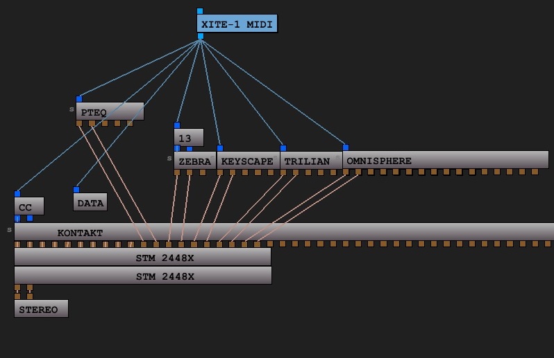

Best forum for custom layouts as members compete with each other to help out lazy guys like me.
I even have SR Pro call up GUIs of VSTs.
Bidule + Scope are the best live performance tools on the market, period..
				- C73F57F0-1F9D-40DD-9653-8E606FC6827D.jpeg (75.74 KiB) Viewed 4422 times
