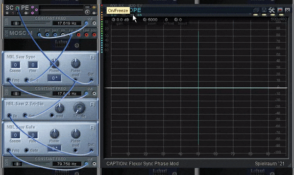

SyncPhase oK |Re: Phase mod in Flexor oscs working
Post by Spielraum »
Spindrift wrote: Sun Feb 28, 2021 6:12 am I noticed a strange problem on my Xite system...phase mod doesn't work on any of my Flexor oscs.
...can someone with Xite verify that they are working?
NOT problem on our XITE system, all oK!
see Flexor`s Sync Logic, only the Sync Gate will set in Phase Mod!
cheers ron
have fun!
have fun!
