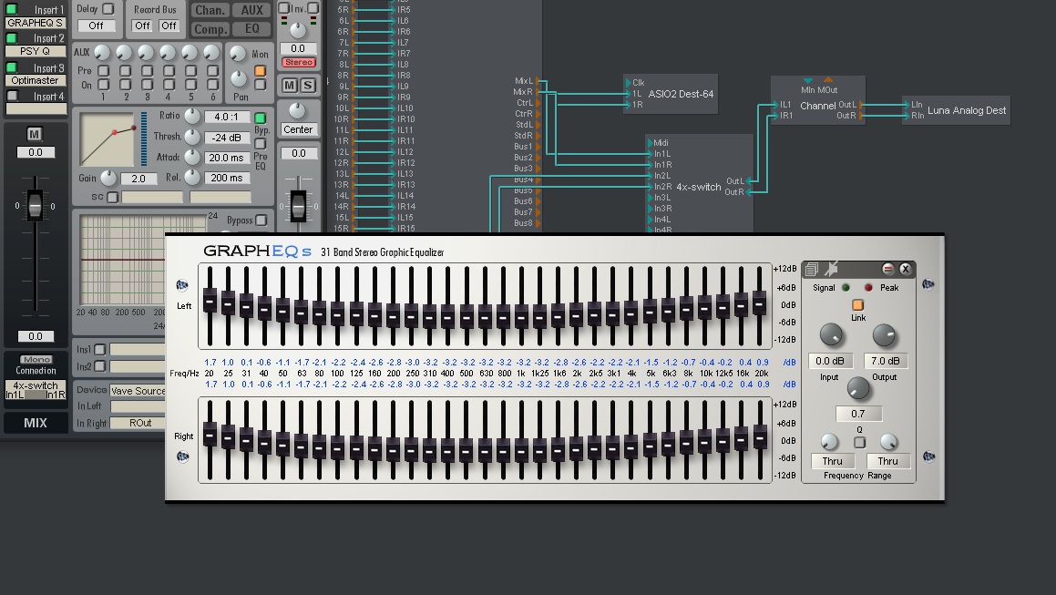

Re: Music producing techniques
Post by fidox »
fra77x2 wrote: Tue May 18, 2021 9:22 am Equalization -> smile face
Something like this ?
I have played little arround with eq yesterday like you suggested and I really don't know , why I'm not familiar with that technique, cause it sounds way better and I understand now what is the point here.
fra77x2
Posts: 506
Post by fra77x2 »
It is called equal-loudness contour or Fletcher–Munson curves. https://en.wikipedia.org/wiki/Equal-loudness_contour
Because human hearing is tuned to the middle frequencies where human voice has the most energy, but this changes with loudness. If we amplify the signal we will hear mostly the mids so a sound sounds weak without enough bass and high frequencies, so we boost the lows and the highs or we attenuate the mids. Of course this interacts with the functionality of the sound and other psychoacoustic phenomena. For an example we can place a sound to the "back" by rolling off some of the highs. (because high frequency content is attenuated with distance) and vice versa. We can place a sound in the listeners face by equalizing it to have the most presence comparing to the other sounds in play. So by equalising we position our sounds to the front or to the back and we also compensate for loudness. And we also control the size of the sound. Now because some sounds should not have too much bass energy so to not interact or mudden our mix low frequencies - a quite common case- only boosting the highs could be enough.

Thanks ! :)
