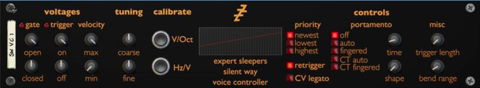

SilentWay Suite + Modular means audio becomes modulation source when using Modular.
I used it a long time ago and it really made Portamento more authentic.
Seems a higher resolution than 0-127 is required.
MIDI Spec 2 CC#88 allows 0-16,000 for PBend, you just need the same resolution I think with Andrews Pedal Steel.

Actually MIDI Spec 2 I speak of was a refinement that’s available now.
Read about SilentWay Suite somewhere in this forum.
You can get PBend resolution which is 0-16,000 applied to any parameter.
Or refine our PBend to higher resolution because “hearing” stepping can be overcome by using audio as the modulation source.
All Scope Modules allow this.

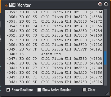

I think you can still troubleshoot this further. Use Midi-OX or another tool to watch the messages. Are you getting both MSB & LSB chunks? When doing a PB alone are you seeing smooth values or is there some discontinuity in the event stream (pauses, skips etc)?
Re: Active Sensing filter in Scope ?
This is what Im getting from the Scope MIDI Monitor (dont have MIDI OX installed). When held bend wheel fully open, there was time for one Active Sensing message before bringing the wheel back to rest position. Looks like 2 in every 3 values is skipped - maybe thats the issue. But when sequencer plays it back - maybe its filling in the missing values.
