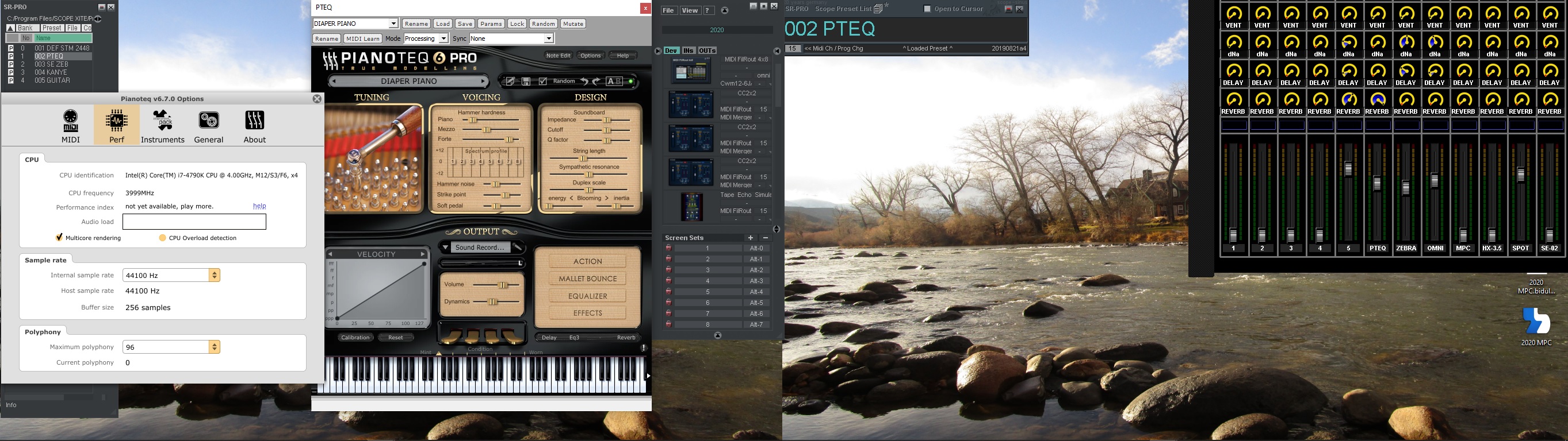

It could be the latest update to Pianoteq but this issue has been bugging me for a while. Every so often there are random pops. I tried various presets in it and no profit. I tried adjusting latency in Scope. No Joy. Tried different MIDI sources, files, and controllers. Nada.
It works perfectly on my Motu unit so methinks it has to do with the ASIO driver. I switched between every ASIO driver in Scope and it seems like it changes, longer times between them but that becomes short-lived.
It's no big deal because I can run it on my DAW and send the output to Scope via MOTU ADAT with zero issues. It's just one of those nagging mysteries I can't get solved. I just hate to have things in the cold-case file, even if they're not serious issues.
I was thinking of using V-Ban (I use it only when I need multiple ASIO devices) but like to keep Scope clean. I was even thinking of trying ASIO4ALL on it but to me, that would be outright heresy! I could never be a Scope infidel after being a faithful evangelist for 17 years! What would I be called? A proctoscope?

Something is stealing CPU time.  Do you have anything in your Scope project besides ASIO & hardware i/o's?
						Re: Pianoteq Pops ASIO?
Sure. MIDI Merger, MIDI Monitors, 2 Optimasters, B-2003, STM-1632, MV Classic, 1 WAV source, 2 WAV outs. 30% across 24 DSPs. I'm thinking MIDI Merger 4>1 or MIDI monitors? Running Process Lasso, machine is tuned perfectly. The only CPU usage is SCOPE and the Pianoteq. Sample Tank has no issues with multiple MIDI channels nor does anything else!

One Drive? Never touch the stuff! I'm on 8.1. Pianoteq only has preset levels of polyphony, 192 is not an option. I'm set at 256. Multicore is fine. Core Parking is disabled.
Removed all Wave modules.
Also removed unused SP/DIF. Better but not 100%.
I increased the ULLI so the Pianoteq buffer is 512 @ 11.6 ms.
Keep Pianoteq at max -6 db.
Saved project under a new name. Reloaded Scope and Pianoteq. Also minimized the Pianoteq GUI to avoid issues with HDMI or nVidia.
Also double checked nVidia settings for Scope and Pianoteq and made some adjustments there so there's no gaming fat.
Profit!
Pianoteq never sounded so great. Really shines now more than ever if that was possible.
Thank you Valis and dawman!
