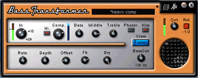

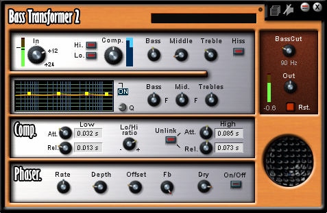

The BassT devices are effects which includes 2 compressors placed after a frequency crossfader.
it allows to compress differently the lower and higher frequencies. The compressor Ratio is "relative to the other frequency (if bass comp ratio is high, then hi comp is low, and vice versa). It pretty easy to find the right comp. The Input and General ratio at the top left of the device is the start point o the compression. ON the bass T2 you can disengage compression from either hi or low. on the Bass T1 , you can disengage only from the high frequencies.
It does not include any amp/cabinet simulation but 2 equalizer stages (1 is classic 4 band curve, and the other is fixed frequencies)
You could add amp sims as vsti, after recording, but I never found one that is really "that" useful in comparison to eqs.

By the way, I think both devices are mono (I got confused by the double comp vumeters for hi/lows)
T1 is the same as T2 but with a button to change "pages". The T2 displays everything at once.

Re: Bass amps / plug ins designed for bass guitar black box 2
Just realized the Bass T1 was freeware and was avalaible on planetZ downloads rather than on the BB2 pack.
so I can attach it here.
With the T2 you can disable comp on both Hi and/or Low frquencies, I thinks that's the main difference in addition to the display (probably some fine tuning here and there too).
