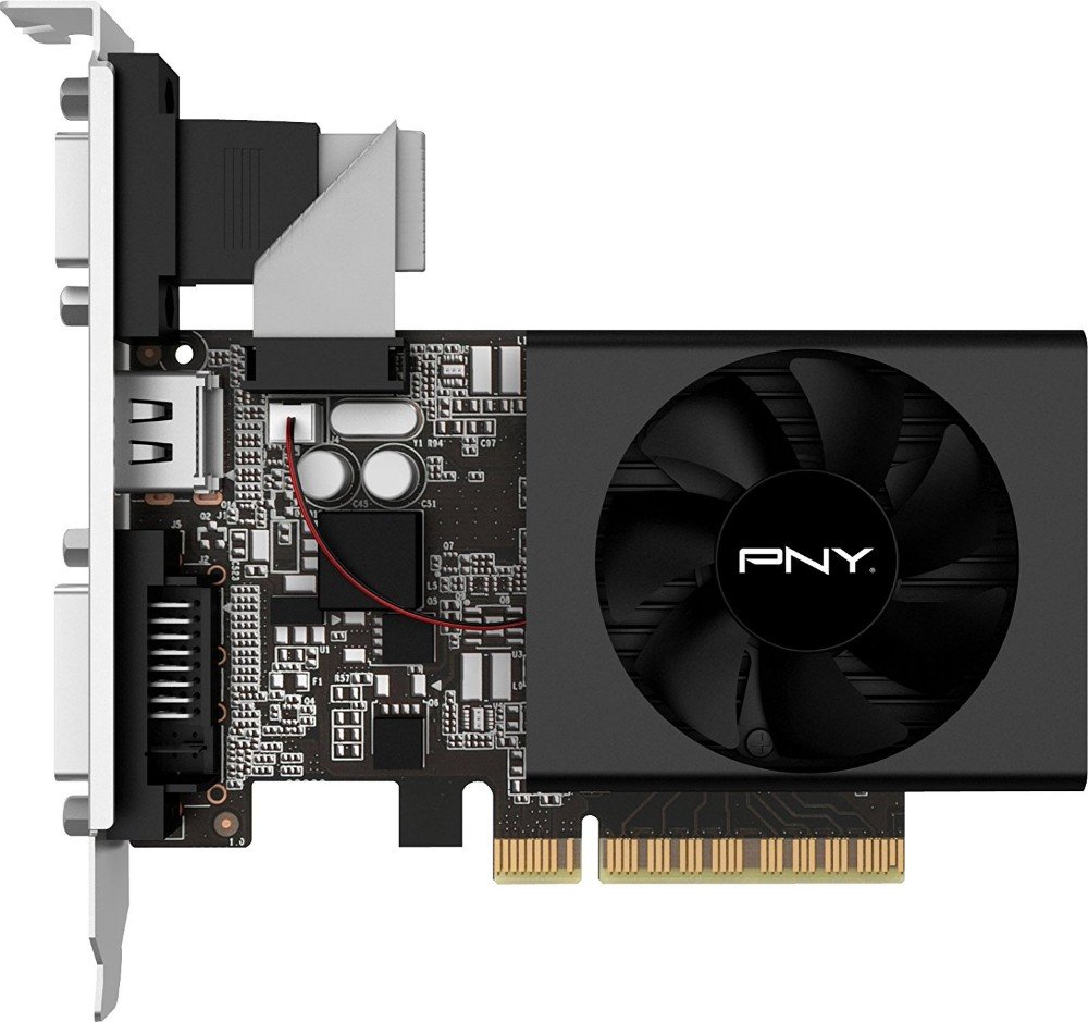

I need a cheap 8x GPU for 2D.
And a 1X for XITE-1 PCI-e.
I’m told the 16X on a Mini ITX has enough juice for an 8 + 1.

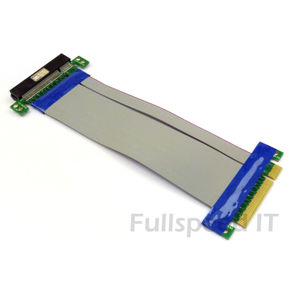

Here’s the GFX 8X Card and connector ribbon.
Just put XITE-1 PCI-e 1X on 2nd slot.

Yea it was the clearance for the GPU i was concerned about, wasn't sure what size case you're using. The ribbon should solve that for sure. :)
