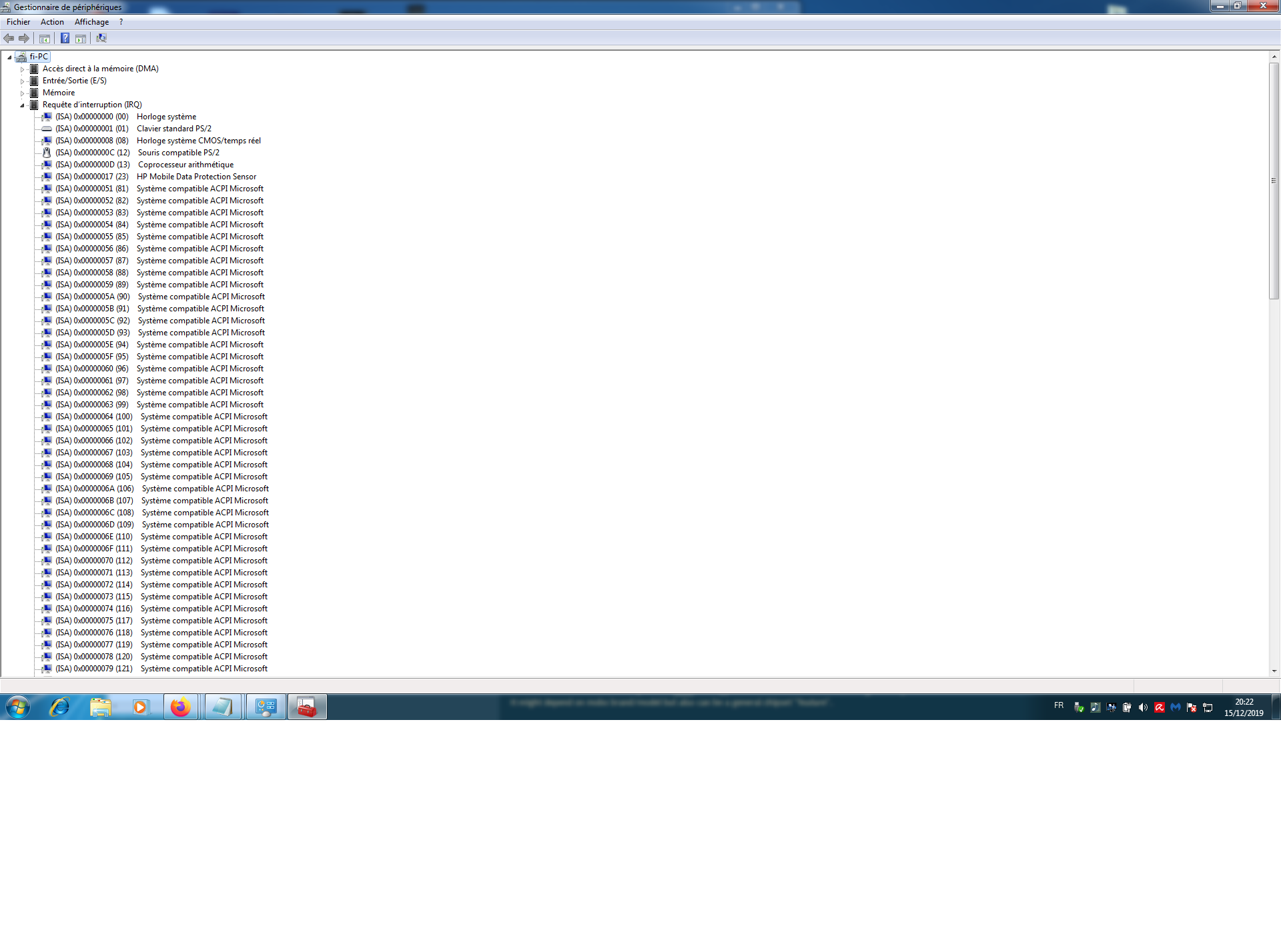

valis wrote: Sat Aug 03, 2019 4:43 am
While it is using an interrupt, the main takeaway is that the GPIO controller device allows modern hardware to talk to legacy ports & devices (on a motherboard, typically) that are much more fixed in addressing than the PCI & PCIe devices are.
As for IRQ sharing I agree somewhat, however let me clarify that in a moment in a separate post, as it may help others over time beyond this discussion thread alone. The main point however is that a shared IRQ on a modern system (anything past Core2 for certain) doesn't mean what it did when our Scope cards debuted. While they haven't changed in their PCI bus implementation, the way that bus is addressed and mapped to IRQs has changed vastly, and this means many devices can 'share an irq' with no issue, even with Scope, imho. That's because the controller chips that are talking to them virtualize the whole address range and interrupt stack anyway, so what 'looks' like IRQ 16 for the same devices is not that at all when looking at the addressing on a lower level per device. It's literally just an address exposed when the 'what IRQs are in use' query is made from the software side.
I'll break that down in that other post, so let's branch the IRQ related specifics off this off to this thread: IRQ sharing, the PCI bus, ACPI/APIC addressing and your Scope cards

asiofixer
Re: PCI Overflow Problem
Post by asiofixer »
DISABLE ALL PERIPHERAL/IRQ THAT WINDOWS SHARED WITH THE PCI/PCI EXPRESS BUS OF YOUR SONICCORE CARD ! AND SEE !
Posts: 7750
asiofixer, everything shares IRQs now, it's all virtualized and there's no actual PCI controller anymore, even that is software. Please chill on the posting, we appreciate that you're back but GaryB has my permission and license to put you on ice again if this persists.
