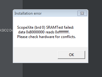

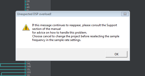

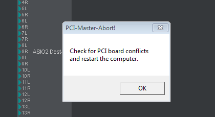

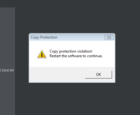

I don’t know if it makes sense to write in support, I’ll just leave it here. Loading any project causes a series of error messages.
If you are lucky, the scope starts working after the fifth or sixth restart of the computer, but sometimes the same can happen at any time.
XITE-1 scope v7.0.1706, windows 7

Looks like a connect fail between the pc and XITE - Try this first:
1. Take out the cable in both ends and reseat the cable. If this doesn't work, try another cable.
2. If the above doesn't help, try to reseat the pci-card in the pc.
If none of the above works, write here again :)

No, cable and card manipulations don't help. - The start up project works well, errors occur if I load another project.

OK - Sounds like the project that you are trying to load is corrupted somehow. To my knowledge I'm afraid there is no solution for that.

the project is nothing big and third-party plugins. as soon as i launch reaper the errors begin

Re: error messages
looks like a hardware issue...

Looks like it's time to change capacitors on the board. :)

I would have an experienced tech give it a look, or send it in for servicing. Lots of things can fail there besides just caps.
Re: error messages
an XITE-1 should probably go to SonicCore, if you need service.
