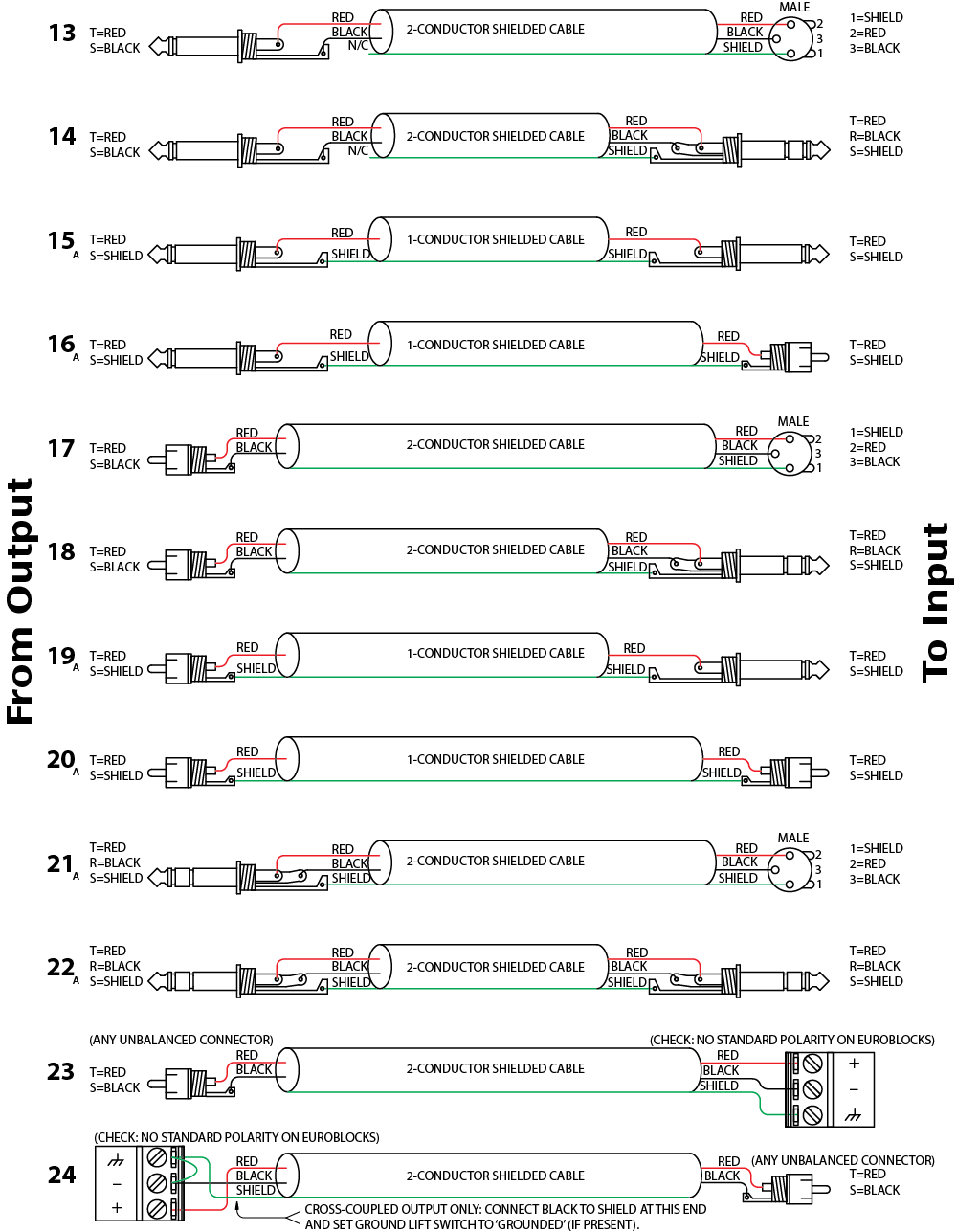

Some time ago, I had the ( stupid ?) idea to use cables which convert asymetrical outputs to symetrical.
This way I attached my old synths to an A16 ultra.
Unfortunately, 50Hz buzz was present more intense than before.
Today I switched back to "mono-cables" and the buzz is gone.
Is there a reason, why I should try to use symetrical inputs for my old synths ?

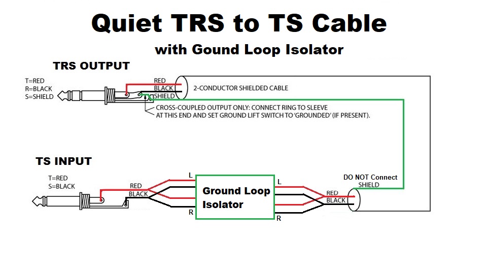

They are not balanced outputs most likely. There are various ways to break the inverted side of the connection documented online, or you can use a DI box (this can also add some nice color), or you can use this: https://www.musiciansfriend.com/amplifi ... eliminator

This is what the Hum Eliminator is doing internally

Here's a good article that covers this in more depth than I can muster right now. I'll attach the relevant image here and reference that it's probably #14 that interests you, but I do suggest reading the article too if you have time.

don't usually need a transformer in the first pic...

I used setup 14, but the cable was 1-conductor shielded. ( so black and green in pic 14 was identical)
When using 15, all is quiet again.
I also tried a DI-Box, but it didn't help. Probably due to my cabling ?
As gary said, I'm happy to find at least one solution, that works.
But being a curious person, I'd can't stop experimenting
