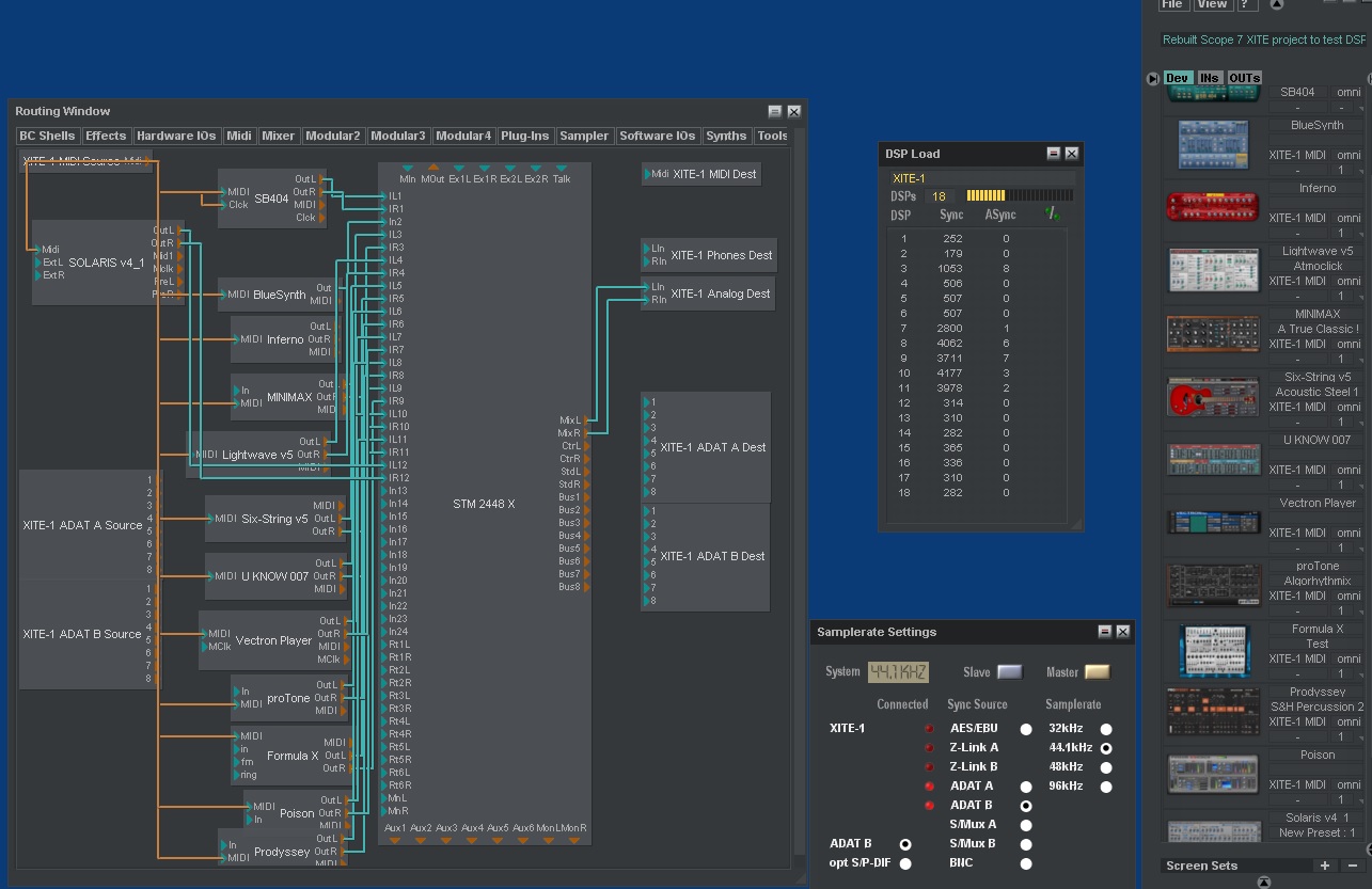

I just recently got my XITE set up again and connected to my DAW. In the same DAW I also have 3 x Scope Pro PCI cards and those have always worked without issues, and I can load large projects with many modules and devices with no DSP capacity issues, up to a point of course.

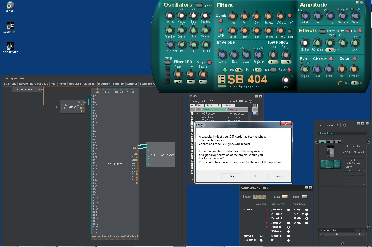

I have just upgraded to Scope 7 XITE. So I wanted to load up a simple project just to check things out, and this happens.
DSP limit 1.jpg (319.48 KiB) Viewed 10983 times
DSP limit 2.jpg (99.78 KiB) Viewed 10983 times
So I tried assigning the supposedly optimised STM2448 X to DSP 7, then tried to assign SB404 v2 to DSP8 but again I get the same error message. Then tried some other dsp allocations but same thing. Some presets seem to work ok, but others throw up this error.
But.....this is just 2 Devices loaded and 2 other I/O modules. I realise the STM 2448 X is a big device in itself, and for this particular test project I could use the Micromixer for example, but I am hardly loading anything on this project and yet it can't even handle those devices. This cannot be right.
So please could someone out there with an XITE-1 and Scope 7 try to load up a project like this and see if you get the same issue. Just open SB404 and select a few presets. Then try preset 7 Bonanza or 43 Minor Trance, and see if the same error comes up.
I will try loading some other devices to see what else it can handle before capacity is reached, but when I compare what I can load on to my PCI cards and what I cannot load even a fraction of in the XITE it is incredibly frustrating.

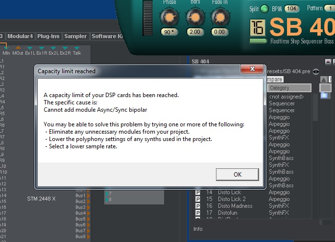

An example of a PCI project I can load without issues.
DSP limit 3.jpg (395.71 KiB) Viewed 10983 times
I have seen other XITE users impressively loaded projects and wondering why they dont have the same issues, optimised or not, especially apparently now that Scope 7 is supposed to handle the DSP optimisation much better. Or could it be a problem with this particular unit? Any help would be extremely appreciated.

Re: Capacity limit of DSP cards Scope 7 XITE 64bit, but HARDLY ANYTHING loaded
the issue has nothing to do with the number of devices or the complexity. it is a specific dsp module that is not working. if you have both PCI and XITE projects, are you sure the device is loading from the XITE directory? if both PCI and XITE folders are present, try temporarily renaming the PCI folder to see if the device loads correctly.
as far as i was aware, the SB404 is ok in XITE, but it's possible that some presets may not work.

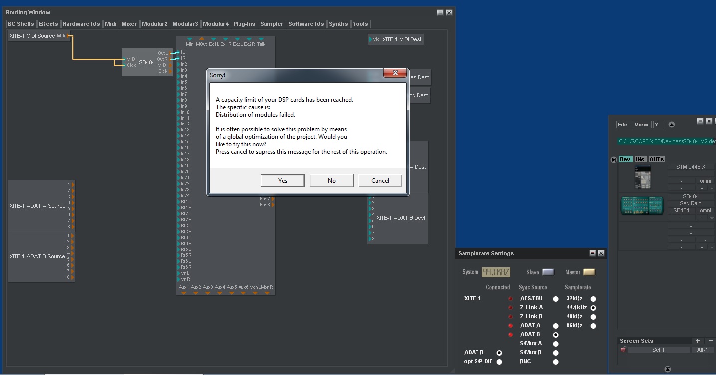

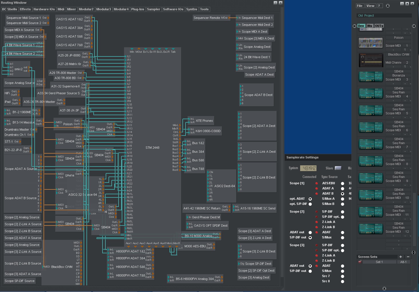

Ok So I renamed Scope PCI folder, then opened Scope XITE, deleted every module in the routing window and rebuilt the project with just some basic I/O modules and the STM 2448 X. Lowered the Samplerate to 44.1, and I am now able to get 1 SB404 running. But if I try to add a second SB404 I get another slightly different capacity limit error.
Capacity Limit 1.jpg (149.42 KiB) Viewed 10942 times
But...I can load up lots of other synths without any further error messages.
Capacity Limit 2.jpg (229.84 KiB) Viewed 10942 times
So I guess this indicates that there is something wrong with SB404 v2, and perhaps even though the devs may have fixed what was previously wrong with that device, maybe something else has been broken in the process. I will report this as a bug to support and see if they can look at it. But at least it looks like it is just this device. I guess it was just coincidence that the first device I tried after setting up Scope 7 was the SB404.
If anyone here on the forum using an XITE and running Scope 7 can try loading up more than 1 or 2 instances of SB404 and see if they have a similar issue. Scope 7 XITE 64 on Windows 7 Pro 64. Thanks as that would help in letting the devs know if this is indeed a bug with SB404

I know that Faxinadu had worked with S|C regarding sequencers in general, and found a fix for a.long time XITE issue that effected SB404 (sequencer) as well as Modular sequencers.
The issue was that the devices needed to be assigned to only a specific DSP to work. I am guessing with "SB404 V2" the root cause of the issue wasn't solved yet, but a fix was added to the device. Since part of the fix was for somethings to be placed only on a specific DSP, that may come with limits such as only being able to load/use 1 SB404 in a project...I don't know though. But that gives you some background on the SB404 issue, and what may have an affect on other .devs that have midi sequencing built in if you see similar problems.
Also: STM2448X (and also STM 4896) is distributed across DSPs 7-10, so it shouldn't be assigned specifically to any 1 DSP.

Ok, had time to try that again, and yes project works fine when I launch without SB404. I was also able to load a project that was saved with 1 SB404, but some presets cause capacity error and the synth needs reloading in order to get sound back.
Managed to get 1 SB404 running, but then I selected another preset and now presented with a new error. Module SDRAM XiteDelay is not appropriate for your hardware...
I quit Scope XITE OS and restarted, loaded up SB 404 and selected another preset and had some other error about cant find Mix 1 module
So as far as I can see this device has not been fixed 100% or something else in it is broken.

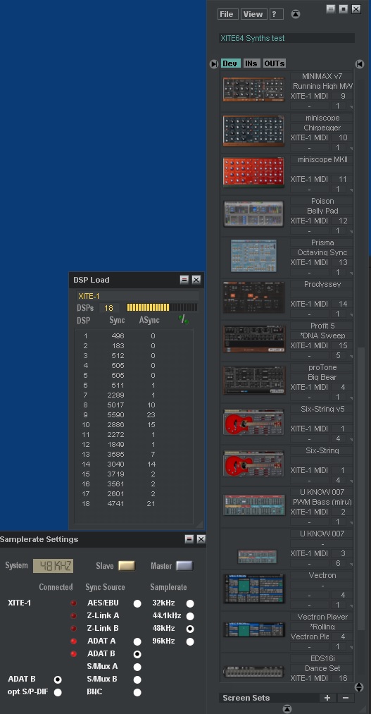

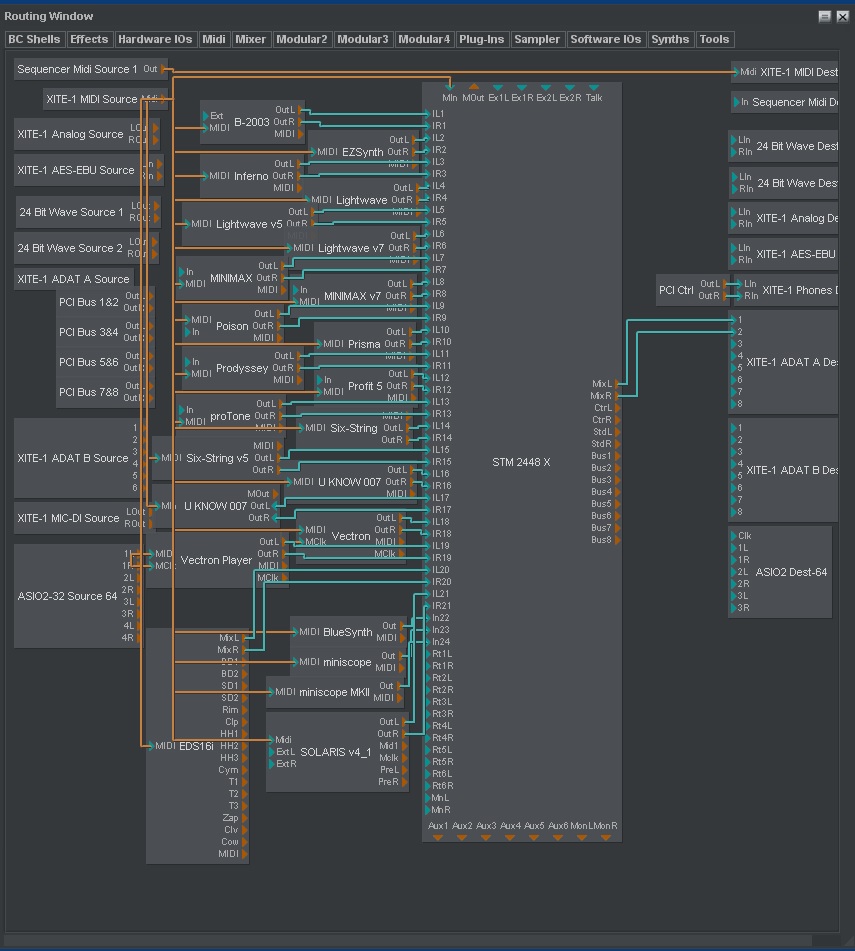

As promised, I loaded up a new project with most the SC synths that come with Scope to the XITE routing window. Connected each one to STM2448X and did no further optimising. Selected diffrerent random presets on each device and that all worked without an issues.
I am triggering these from a Cirklon sequencer, but since I only have one midi port allocated to the XITE from my external sequencer I have set a few devices to the same midi channel.
This was tested on Scope 7 XITE 64, on Windows 7 Pro 64bit
Project is using the following devices.
B-2003
BlueSynth
EDS16i V2
EZSynth
Inferno
Lightwave v5
Lightwave v7
Lightwave
MINIMAX v7
MINIMAX
miniscope MKII
miniscope
Poison
Prisma
Prodyssey
Profit 5
proTone
Six-String v5
Six-String
U KNOW 007
UKNOW_v112tm
Vectron Player
Vectron
And finally John Bowen's Solaris v4.1
That is 24 synth devices running on this project.
All devices are at 1 voice polyphony apart from the B-2003 and the EDS16 V2 which are unlimited by design, the two six string which I set to 4 voices, and the Profit 5 which I set to 5 voices. I was able to add more voices on several other synths, but I wanted to leave a little headroom for dsp loading and in order to reload the saved project without any problems.
Routing windows showing all the devices loaded in to project.
Routing Window.jpg (188.98 KiB) Viewed 10667 times
DSP Load, etc
DSP Load & Devices .jpg (121.28 KiB) Viewed 10667 times

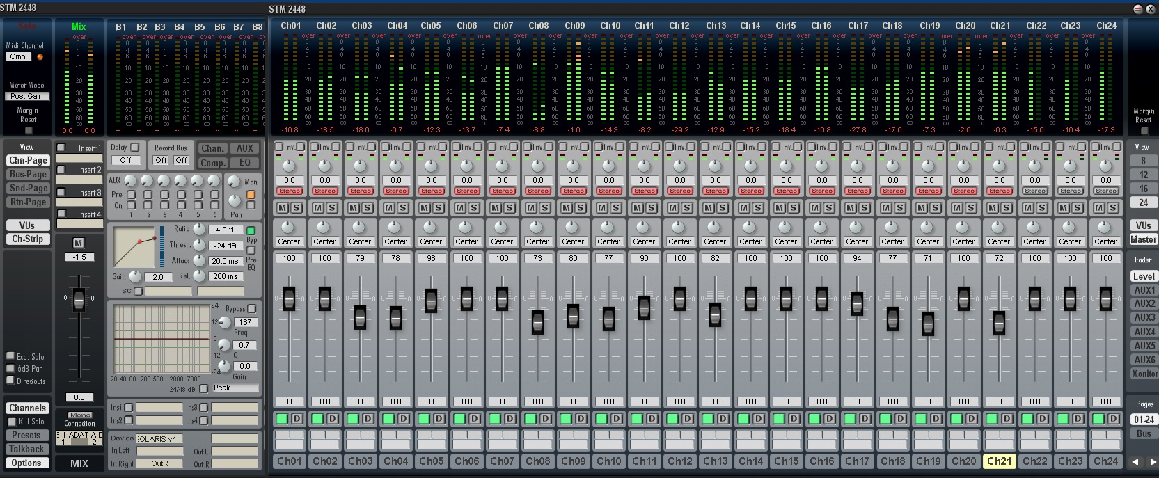

STM2448X with all tracks playing the synths
I will try to load the project when I can find out how, and also a short example piece of all the devices playing sequentally.
When I have time I will also try to swap out some of the devices and try out some of the third party devices and see which ones work well and others that have issues loading up. I dont have time to try every parameter on these devices as this is just a rough and ready exercise to see how the devices load up on Scope 7. So far the only one that is really causing a problem is Sb404. There may be others that have some bugs here or there, such as the sequencer bug, etc. But otherwise I am very impressed.
Hope that helps some :)
