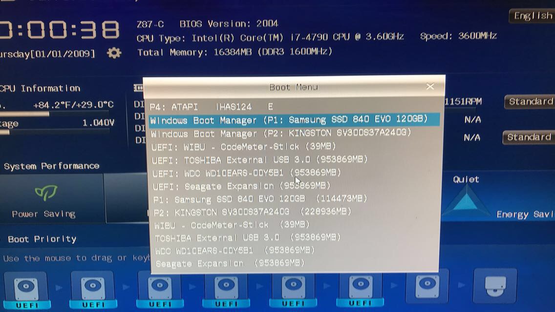

t_tangent, see screenshot below of BIOS, the boot partitions and the sizes. They are separate SSD - 120GB and 240GB

Thanks for the picture Dante. Unfortunately for me it seems my bios doesn't have this feature, so just using windows boot manager. Will also get another ssd for sample libraries etc, as it has made a big difference already having the OS on SSD.
