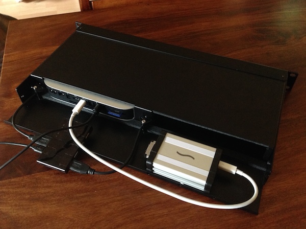

Another idea for a one space solution with zero noise is to get a (used) MacMini and to put it in a Sonnett RackMac Mini for example.
Like so: http://www.hitfoundry.com/issue_26/mac_mast.htm
