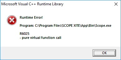

Re: Scope 7 Bug List
Scope 7 Plug In : SC-BrickWall EQ Crash :
OS : Win 10.0 x64
HW : Scope XITE-1D
CPU: i7 4790 (not overclocked)
MB: Asus Z87
RAM: 16GB
ULLI : 12ms
Sample Rate : 96KHz
Reproduce: Drag and Drop SC-Brickwall from device menu (Effects/Stereo/EQ/SC-Brickwall EQ) to project window.
R6025
R6025
This previously occured on Windows 8.0. Now it still occurs on a fresh install of Windows 10 Home. Both Scope 7 PCI and Scope 7 XITE
