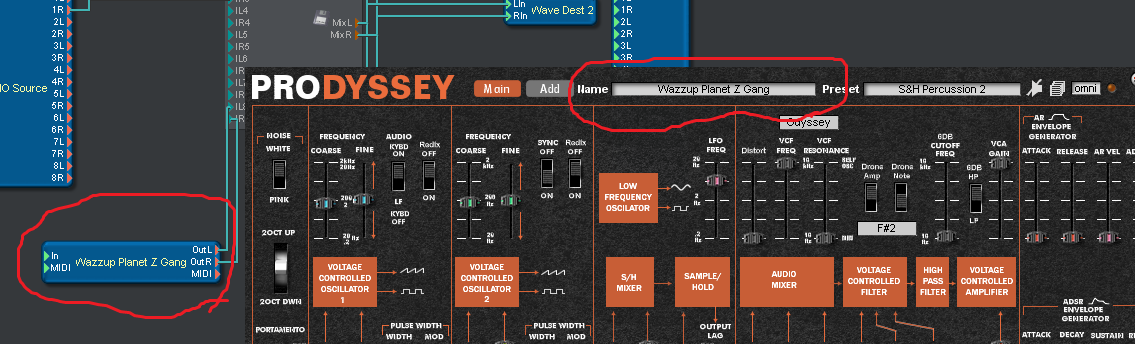

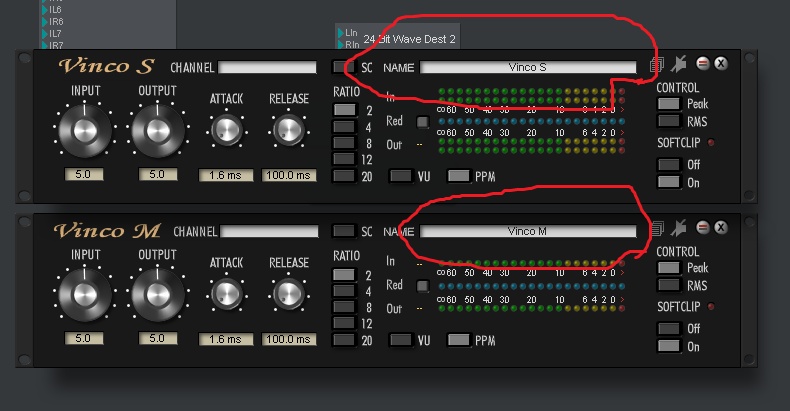

btw some small tease - i'm working hard to get us device naming on routing window for next 7.x :)

not officially but with lots of love :) i'm just enjoying the ride down the rabbit hole. i don't even consider it helping, since its a pleasure and honor and at the end of the day i make my music using scope :) fernando and i have an excellent relationship with holger and for sure as time passes we are able to offer more as the relationship and our skills and ideas develop. every day is still learning and experimenting.
at the moment outside of ocean swift stuff i'm working on those tweaks i showed in the above screenshots and some mods to scope devices and was doing a lot of testing in the days before v7 came out.
