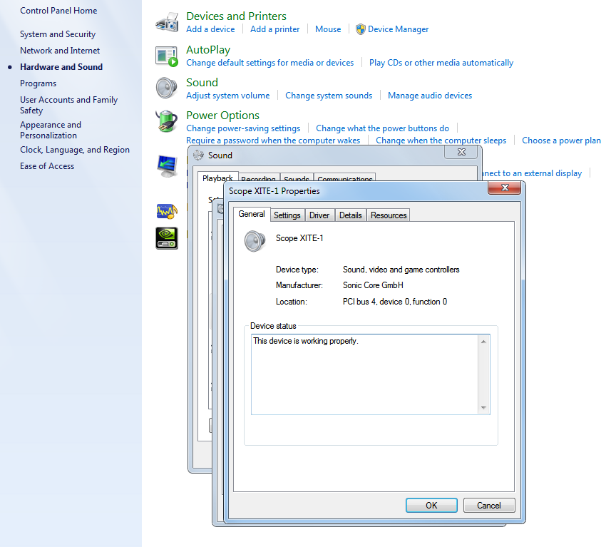

This is so strange - It is not working properly!?
XITE - Working properly.png (95.05 KiB) Viewed 1523 times

OK - The problem was that I have been running my XITE in slave mode, slaved to my SCOPE PCI-cards. For some reason this works best.
Anyways, not having the XITE hooked up to the PCI-cards over ADAT and still running in slave mode resulted in the above behavior.
All is good now. Back in master mode for now - let the romance commence :)
