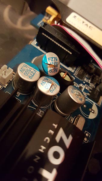

Re: Help ! Has my old faithful Pulsar 2 finally died ?
Yep...look like this...is on a gfx card, but this is how those bastards look.
- burst caps.jpg (56.83 KiB) Viewed 7359 times

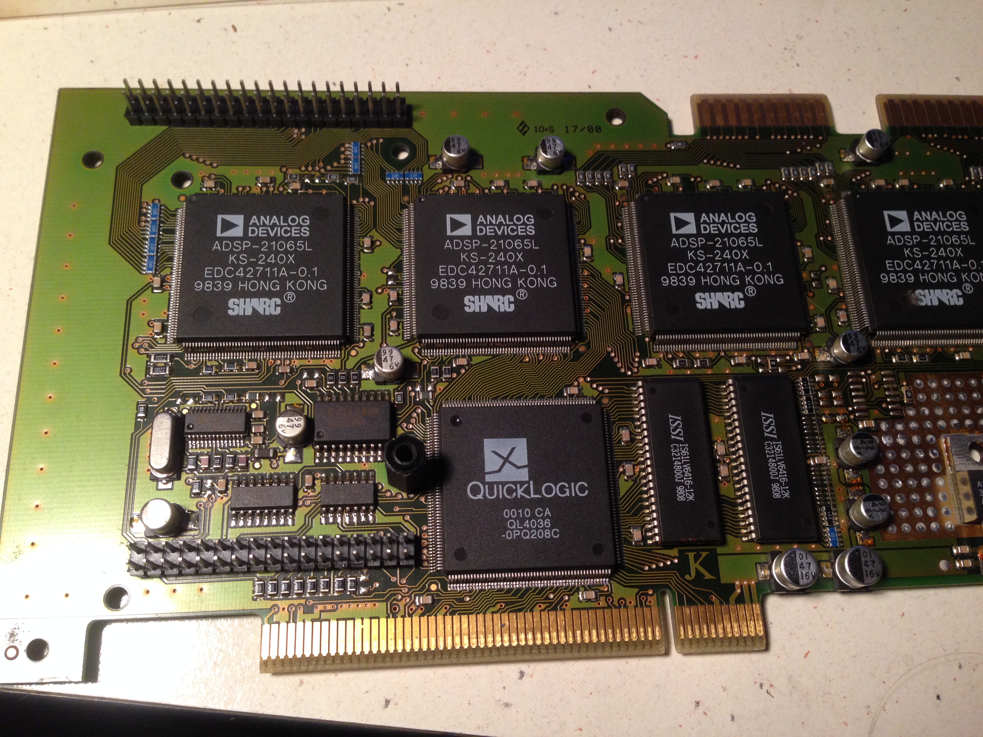

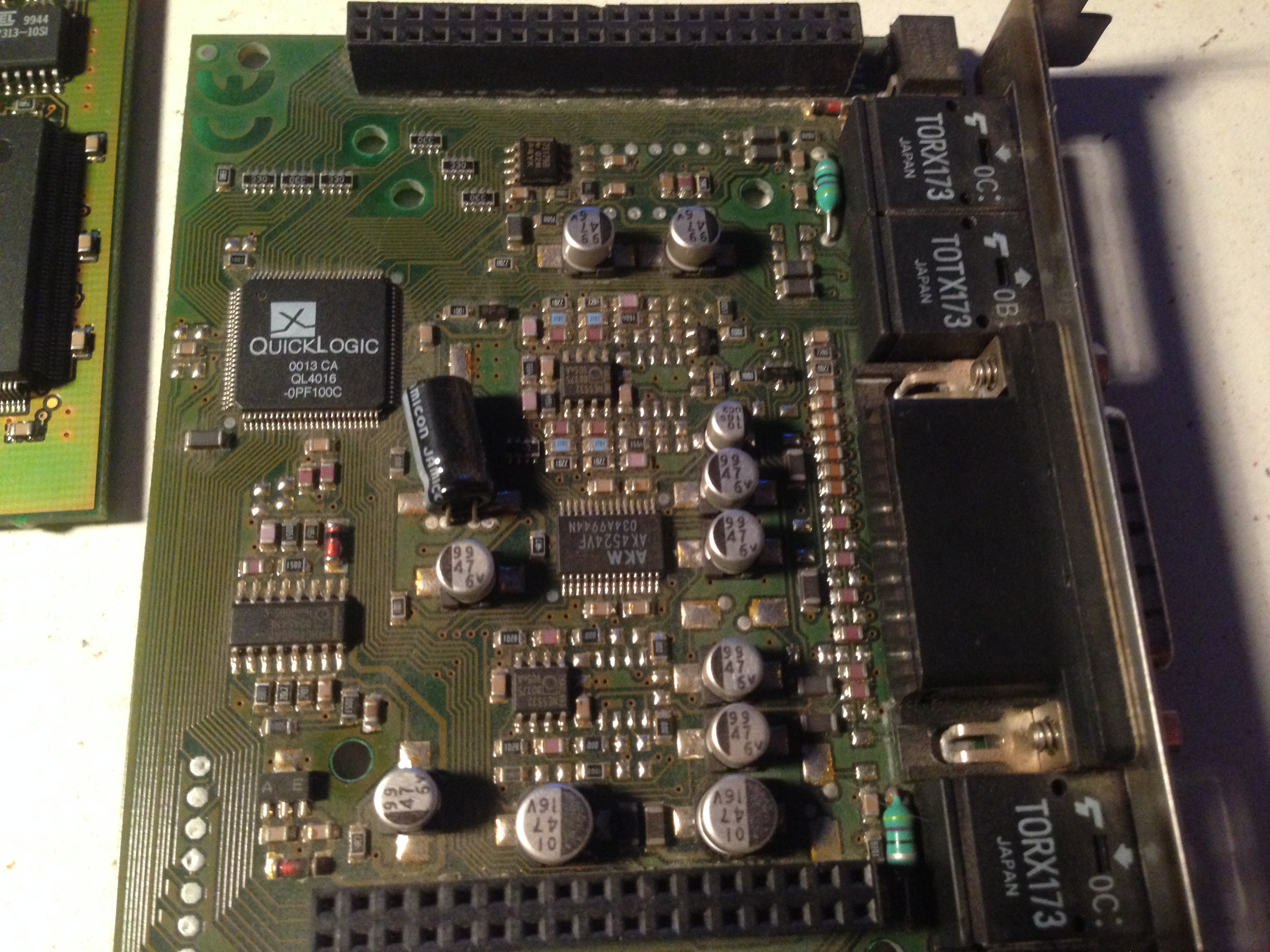

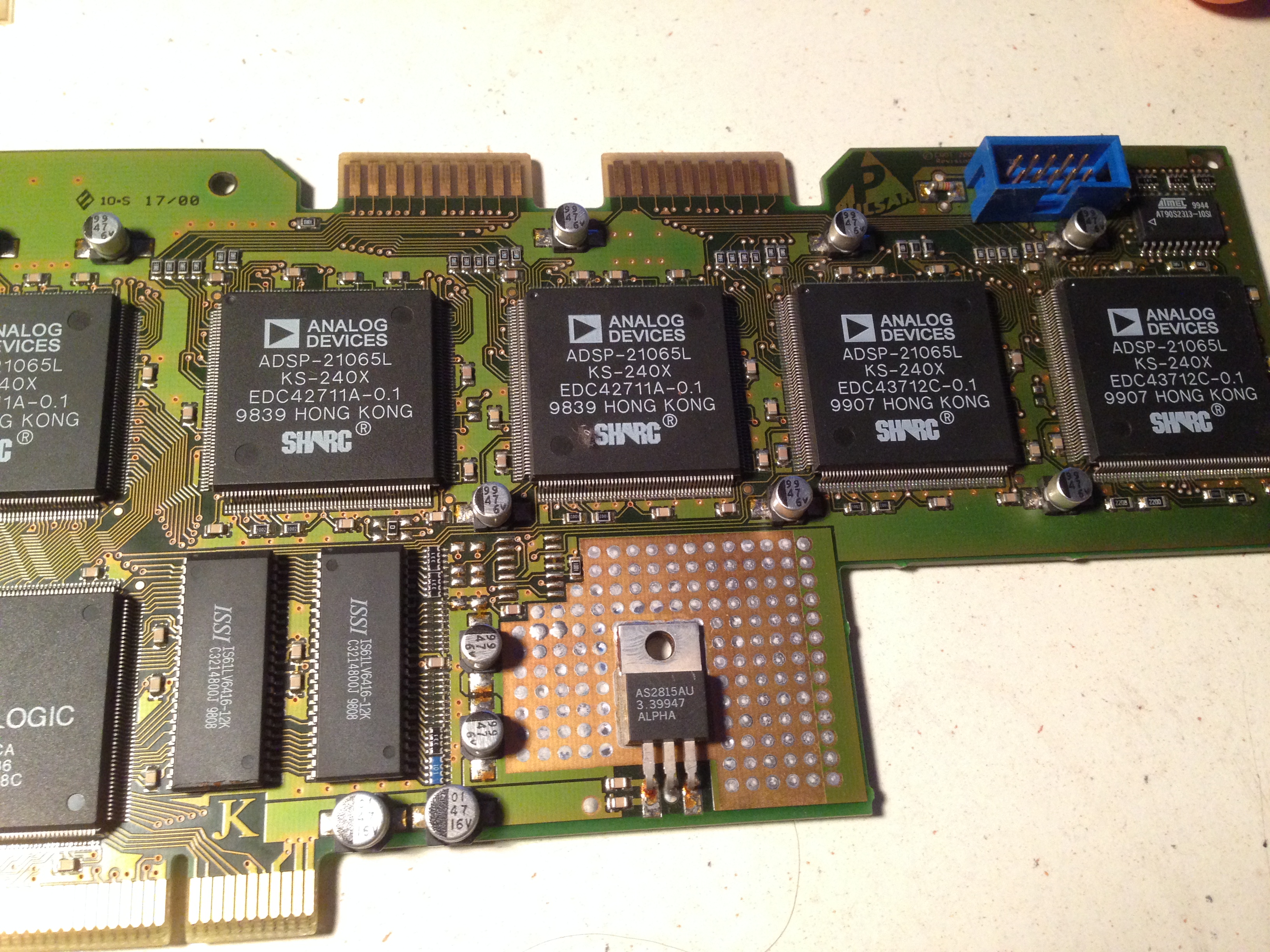

Heres pics of the card ( i took the i/o off to check caps underneath)
No obvious explosions or anything which looks out of the ordinary...
No messing around with system prior to failure. It just started to generate DSP / connection errors BUT with some jiggery pokery I could always get Scope to load.
Now however, no loading of scope possible and just the errors posted earlier.
ps - thanks, RA, I just saw your edits. nice plugins, btw !!
i seem to remember jhulk does repairs?
i will investigate further but starting to think it has to be the card now.
How does the other side of the card look, does it have any strange things you see,
maybe cleaning a bit, and try after reassembling the io board, maybe it was in there...else....try jhulk,
he can and will probably help you further if he got experience with this.
Maybe there are some things which keep reoccuring.
Let us know your progress.
Thanks!

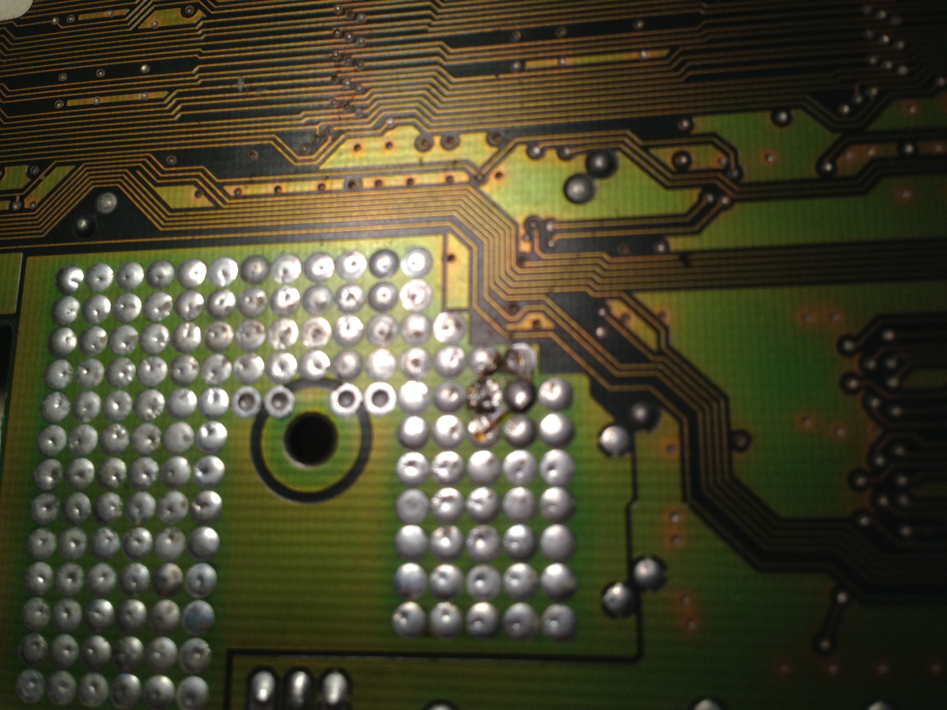

uh oh......
some of those solders looking nasty...
- IMG_5926.JPG (2 MiB) Viewed 7340 times
that doesnt have to mean anything, but the residu from the solderstuff...the brown stuff can be removed with a cottonswab dipped in some aceton.
try it on a corner first, but that's what i use a lot for removing that stuff....but again, it doesnt have to mean anything, but can always try...

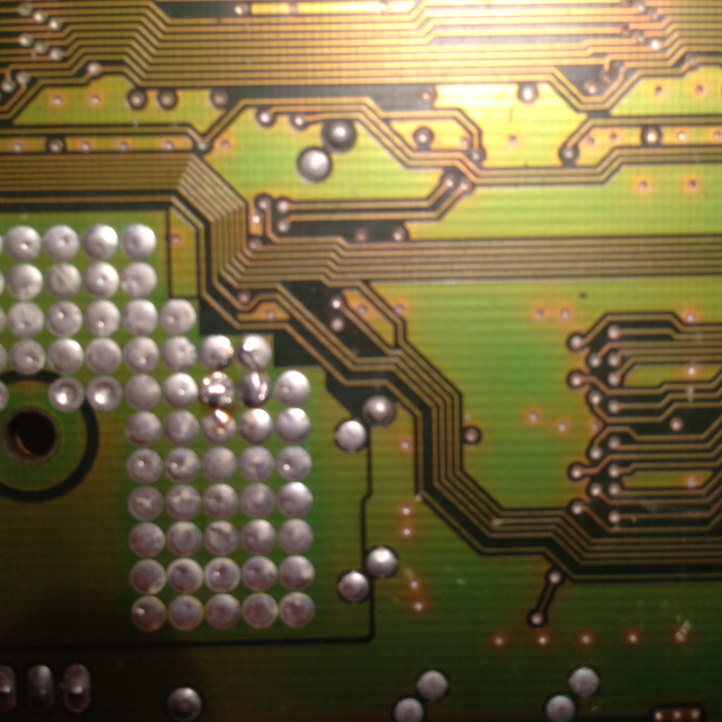

just gave it a clean with 99% isopropyl.
the solder in the middle looks like it has spread and is now in contact with surrounding solders..
have followed your advice and sent a pm to jhulk and dante.
keep you posted and thanks so much for your help !
- IMG_5927.JPG (1.26 MiB) Viewed 7332 times
Ok...no prob. Youre welcome. Thing is on the pic it seems all those contacts are on one big copper plane...the light green plane...that could mean that the contacts are just dummies Or all connected to eachother..could also be a multi layered pcb...i dont know that kind of specs. You can measure that with an ohm meter. But jhulk will be of some assistance probably. Thanks dante for this interview on scoperise.
the solder looks normal.
I noticed there is a cracked chip. Perhaps it got knocked when you were switching things around inside your motherboard?
I do not have any idea whether this would cause a problem or how to fix it.
