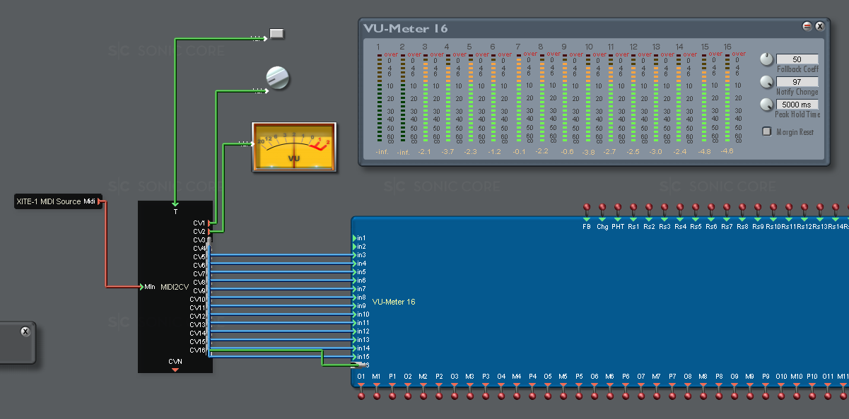

So, here is the 1st device: MIDI to CV, 16 CC values can be handled with teaching button: Press the button, apply up to 16 different CCs and press button again. The state will be saved, so next time, you don't need to teach again. The ini file will be automatiically generated in the app directory. The dll goes the usual dll dir (for ex. C:\Program Files\SCOPE SDK XITE\App\Dll). You need the VS 2013 runtime dir too (https://www.microsoft.com/en-us/downloa ... x?id=40784.

If you got a MIDI keyboard controller, it might have some CC controller as well (buttons, sliders, pots etc). If any of these can produce CCs (Continuous Controls), you can use these outputs to control any potentiometer in Scope. It can be volume, frequency, time - whatever comes to mind. AS exmaple, you can control the frequency of a LP Filter like a Wah-Wah from your keyboard. If you keyboard controller allows a foot pedal: her you have your wah control connect the Midi2CV out to the LP Filter F control, push the T button, move the pedal, push T again and you're done.

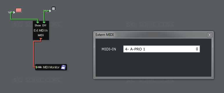

A new module: external MIDI IN. If uou encounter note-hanging, push the off-button. To selct the Midi In device, push show and select the device from the combobox. Enjoy!
ext midi in.png (20.4 KiB) Viewed 24295 times
If you encounter hanging notes, please tell me. There is a speed limit within Scope, which gives problems at BPM > 160. I might need to increase the buffer.
